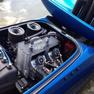

Sanoman took a cool vid of his hood getting sucked down on his freak . I think he was only breathing thru a x metal . Scott s showed me this a few years ago.
Seems like Art told me a long time ago you need a MINIMUM of 1.5 times the carb size. Ie 44's need 66 mm of breather tubes and so on.
The hulls are getting smaller and the availability of space is limited to run the tubes to the bottom of our hulls. My experience is that if you run tubes in shallow you ingest a ton of water.
Question:
What if you made a ball type valve that closed when the ski was up side down ...." my ski is in that position that a lot". It would have to be custom have not seen any thing off the shelf. The ball might have to be to heavy in order to work properly.
