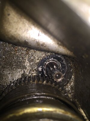

Grrrr this totally blows. One of the starter bolts is even missing and I discovered a few more bolts missing from the crankcase. I swear this guy did such a half ass job swapping motors it's starting to piss me off.

The starter is no bueno. gear is stripped at tip . You need a total teardown and replace with minty used oem parts as needed, they are actually easy to find right here on the X it will save you money in the long run . Good luck

Yup I pulled the motor today and swapped out the starter with a spare I had laying around. The battery was low so the engine wasn't turning over but at least the bendix engages the flywheel properly now. However, after charging up the battery all I hear now is the relay click when trying to start. I sure hope I didn't fry the new starter.. :(

So I swapped out the internals of the starter with the housing of the OEM one that had a stripped gear. Works great even though I just ordered a used starter today. And the bogging out problem was because the main fuel line got disconnected lol Tomorrow will be my first chance to finally take it for a spin
