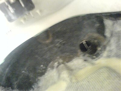

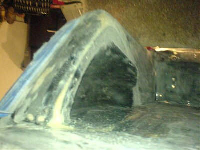

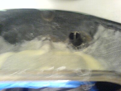

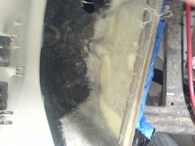

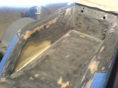

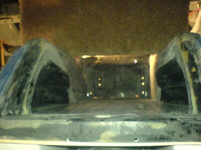

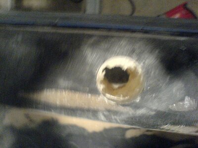

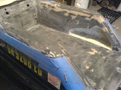

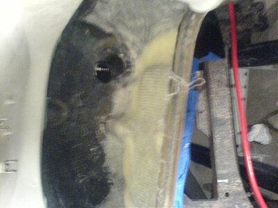

US composites order came in. Starting reinforcement.
1) handpole bracket area - foam depressions and 3 layers 1708 biaxial.
2) reinforce nose - 3 layers 1708 biaxial
3) firewall
4) both sides
5) glass footholds and tray

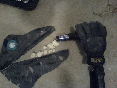

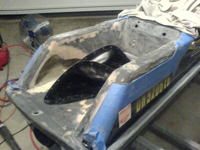

Here's a couple pix of my footholds all installed... still need to glass in... but they have already been glued/ screwed/ screws removed and holes filled

Nice work so far!
why are you reinforcing the firewall?
Thanks man.
why am I reinforcing the firewall? - Just cuz I was told that this was an area that I should reinforce... I don't really know why to be honest.
I was told to just do the firewall down to just above the intermediate shaft.
i dident due to i ride in lake erie more then the ocean. 99% of the time... extra weight was just not needed.... for the extra little support. just my opinion. also why i dident do the bottom. that was just my buddys idea and i went with it
