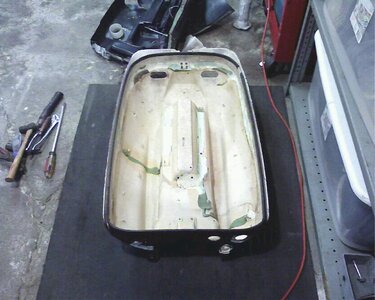

Thanks guys. I just finished putting turf on the other foothold/side of the ski last night... already I am getting much better at turfing....
It went pretty well.
One thing I was wondering is: if you accidently scrape your gel coat with the razor blade (about 1.5" scrape) all the way through the gel coating.... is there a way to fix? Any recommendations? It isnt terrible, but it urks me that it is there and I want to fix. Thank you.

you have any pics on your liner less hood you recomend it is it still structural
i pulled the liner out of my hood so i can cut it into a lowered hood. I will be making a new liner. You need some kind of liner to prevent water from pouring into the motor compartment... and to ad structural strength to the hood.

dang! You've done alot! I put my foot holds in, and reinforced my tray... But I didn't reinforce anything else. You must be planing to go big! I'm hoping to get some parts in come spring. I definatly need a prop. How you like yours? Also Why not try cutting your hand pole down for now. I got the xmetal set up and I cut my pole down. Works good

I dont plan on going big... I plan on trying to go big and falling on my azz :smile: I like the prop I have... I did notice a little difference when I changed to the solas from the stock. I was planning on cutting my handpole down for now, but I have decided to go x-metal... I like the way their poles look better than stock, and I already have my ski torn apart so now would be the logical time to switch up.
I would DEF. recommend reinforcing around the hoodlip and the handpole bracket... many people told me to do that.

what do you mean the hood lip? the hood itself? or where it sits on the ski body? I didn't renforce around the pole bracket, do you do this underneith? I need to get a new hood seal.

yeah... like right under the hood seal (not under the seal itself, but in the engine compartment up under where the hoodseal sits)... I put cabosil mixed with epoxy up in there and ran my glass right over that when I reinforced the sides, firewall, and bracket area.
I then trimmed it all off with a dremel to match the lip all the way around.
The bracket you would have to reinforce from underneath...
I am going to be learning nose stabs and will attempt a few rolls after I get the stabs down... as I am learning rolls I wanted to have the sides and the hoodlip reinforced... I reinforced the nose in case I hit bottom... the tray and the firewall I reinforced for the heck of it... and the handpole bracket area is prob a good idea to reinforce no matter what.

what is that cabosil mix?
Aerosil/Cabosil... check out US Composites website... you can get it other places too... it is a strong filler... mix it with your epoxy to a peanut butter consistancy. It is like snowflakes... really weird powdery stuff, but it works great!
