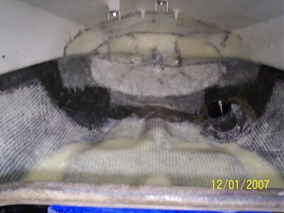

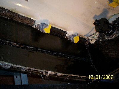

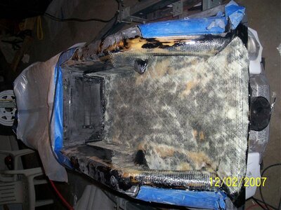

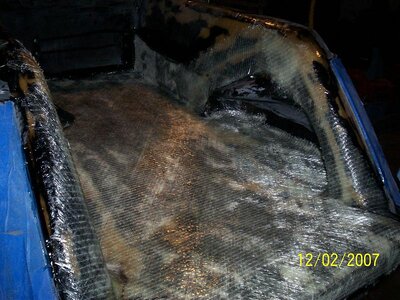

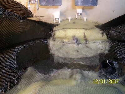

15 hours of work today.... reinforcement is complete except for just glassing in the footholds and throwing one layer in the tray....
layed about the equiv. of 3 layers of 1708 in the nose
1 layer of 1708 on the bulkhead and both sides all the way to up to the nose
then 1 layer 5.7 oz carbon fiber on the bulkhead up to the nose
The last one looks a little sketchy as far as the how far the carbon fiber stretches out into the nose area... but I did not want to spend the extra time and money to put carbon into areas that nobody would ever see unless the gas tank was out... figured this is what most people do.... I prob put it farther up than some would have

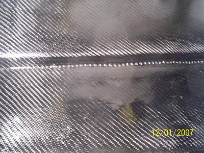

I dont know if other people do this, but I put the carbon fiber in and the edges where kinda un-sano so I used carbon fiber tape which stays nice and shaped and put it around all the edges after I was done which made it look nice.

Did you get the carbon fiber tape from US Composites too?
Yeah I got the tape from US composites.
I put the carbon fiber 2x2 twill on the sides all the way to the bottom, and it kinda had frayed edges onto the bottom which I didnt like... I used the tape to cover the edges... the 2" tape worked perfect to cover that first hump on the bottom which covered all the frayed edges...
when I put the fiberglass down I extended it onto the bottom about 2" so the tape covered that up too...
i could have possibly cut the carbon fiber cloth to extend onto the bottom, but I didnt... so it was nice to have the tape to kinda touch it up..

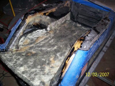

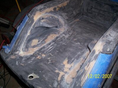

Today I got the remainder of the reinforcing done...
Also, I bought a Wamilon lowered hood on ebay... its used but in pretty decent shape from the looks of it... plan on painting it white.

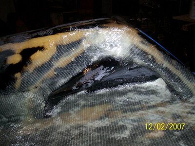

oh, and holy tray reinforcement batman!! yeah, the milky color has happened to me a few times too.
did you brush a thin coat of epoxy down before you laid the glass?

Yeah I put a coat of epoxy down before and then another on top of the glass and then rolled the crap out of it.... the only thing I could think of is that perhaps the epoxy began to setup in those little areas before I started rolling and would not absorb all the way into the middle of the thick 1708 cloth... I don't know if I should be worried about it or not... white spots just freak me out since I don't have a ton of experience doing fiberglass... glad it didnt happen anywhere else... if I do have to do something drastic to fix it at least it's in the easiest area to get to...
by holy tray reinforcement... does that mean I went a little overkill? hahaha
you should be ok... i wouldn't worry about it.
yeah, i usually only reinforce between the footholds, but that's cool... you'll be all set now.
