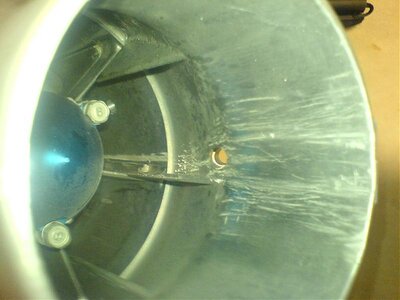

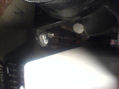

Did up the dual cooling today.
Also, ground down the old bilge pump exit piece that sticks out into the nozzle.
I have since filled the hole from the old bilge fitting in the picture above with JB Weld and sanded it very flush and smooth with the rest of the nozzle.... like it was never there...

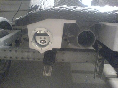

Thats a fine setup. I purchased a XFT 3" Monster Valve scupper which I am going to install soon. I like the scuppers and one ways and will keep my 500gph rule bilge, but like crab said... my bilge prob will not be running a whole lot.

didnt know you were going to install a scupper.... that makes sense now...
probably wont be needing those bilges much
why did you install footholds first though?
wouldnt it have been easier to install the scupper while the holes for the footholds were open?

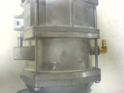

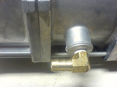

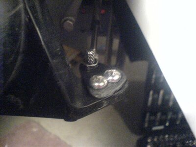

Installed MSD enhancer and finished my quick steering mod today...

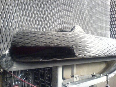

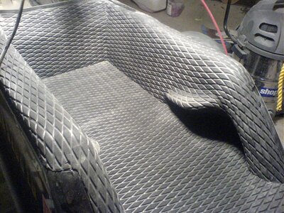

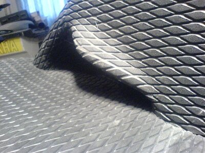

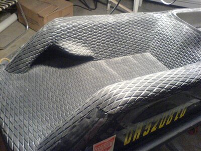

Here are some turf pics Mike...
Ski is a bit dusty from all the sanding I have been doing on that Wammer hood so it looks a little dirty...

on the rail down how'd you get your turf there with no seams or cuts
ive always had to cut
you heat it up and bend it around??
thanks looks good
Nice scupper too
Thank you. Mostly I followed the turfing without seams thread in the FAQ section... but also put my own spin on it as I went... I did use a little heat to help
Ericfox
Do it twice?That's DooDoo
yep. Thats what I did. Also, replace razor blades very often... will help make clean lines... I read that on here and was told that by some people as well and those people were right-on with that advice.
