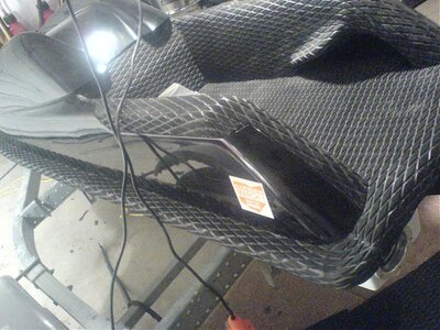

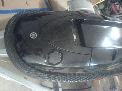

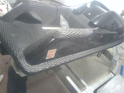

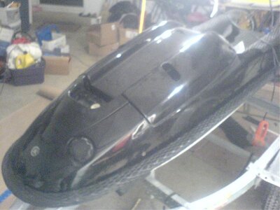

Tonight I widened the rails with flat hydroturf. Next, I applied black diamond hydroturf on the rail. Looks nice...
Sorry some of the pics are a little hazy.... the 2 500 watt work lights near by are kinda bright for the camera.... plus not that great of a camera anyways....

This is some good lookin stuff man...I am doing all of the same stuff to my SJ. Got the ski torn down completely and have sanded the inside compartment and whatnot. Also, i did the same amount of glass in the tray as u did. I figured I may as well, a lil extra weight wont hurt, i dont wanna take that stuff apart later to fix a crack. Unfortunately, living in MN, i have a lot of time so i only work on it about once or twice a week. dont know anything about the cabosil stuff, but im using the foam from uscomposites to fill the bond line and nose like u did. I have some pics but have been to lazy to post or anything. But great looking job so far man!
