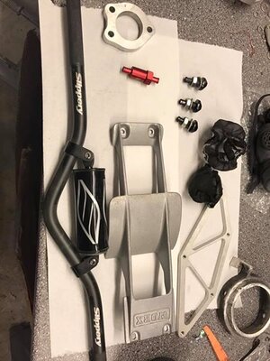

I have one laying in my garage for sale. dunno were i got it THB. Dunno how much shipping to US would be if you would be interested
That would do the trick! I couldn't bring myself to grind the pipe just to ride for a month, so i am trying to liquidating some items to just buy a PFP and do it right. Part looks pretty simple, it might be cheaper for me to just fab it instead of shipping if I do end up running the B pipe.
Appreciate the offer though man.

Yeah, np man. I guess i can ship it as letter for 10usd. I think i paid 45 usd for the part, never used or bolted.
Yours for 35usd shipped (given that it ship as letter, sub 250gram) :)
