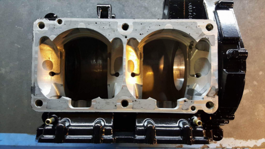

Motor showed up today, showed up well packaged with no damage. I agreed to have him use used cases to cut down on build time instead of waiting on OEM to show up but I am a little concerned about the gray epoxy in the stator area. Was this case cracked at some point and repaired?
No it was not lol, you see when you try to stuff larger sleeves in cases designed for 701/760 displacement. You have to make room for them, what your seeing is epoxy. But it was not damaged at one time, it was added as a strengthener/filler material so that Art could hog the cases out for proper sleeve clearance/porting. Perfectly normal
Awesome man thank you for the explanation!
