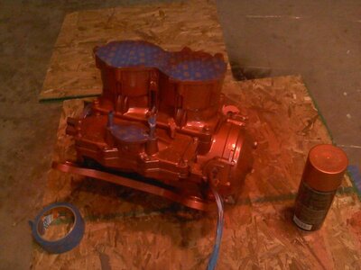

CIMG0380.jpgCIMG0376.jpgold 650 motor on the left/"new" 701 on right

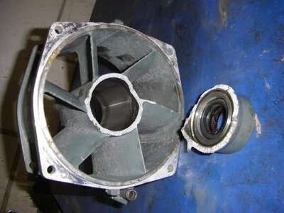

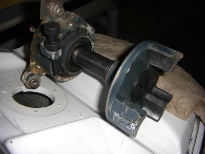

CIMG0398.jpg-Sand blasted OEM pole bracket and midshaft bearing... painted black

I don't think it matters but your Ada head is on the wrong way. Love the color you went with for your engine.
Sent from my iPhone 4s using Tapatalk
Actually it does, water comes in the manifold side and needs to exit carb side.
If water exits manifold side, carb side will never get enough water to cool.
