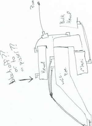

would this work for my cooling? View attachment 214334 Sorry cannot figure out how to rotate...

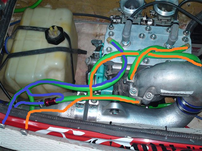

It could work but you are either putting too much water into your stinger or not enough into your pipe.
See attached. Note that the original image was also incorrect. Go by the new lines drawn overlay.
Yes, you can still do this even if you only have one line in from the pump, but it is intended for 2. You may need to put a restricter on the one pisser so that enough water gets sent to the pipe.
Also note I'm not familiar with your pipe or the pipe in the picture. I assumed the lines going into and leaving the head pipe were in the right places. I'm not sure which nipple is the correct in on this pipe or on your pipe. The rest of the layout is correct, just make sure you go to the right in on your pipe.
I guess it doesn't matter. I run my lines on my B-pipe opposite from the way they say I should. They say in top out bottom, but I go in bottom out top. As long as the water flows smoothly everywhere it's supposed to in your pipe.

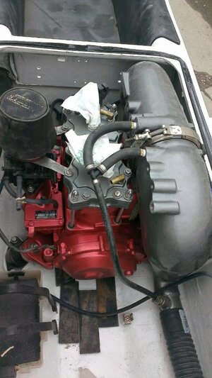

mail.jpgThe black water line was already setup like this(the two on top connect to the Y fitting to the stinger...), so i figured, this is how it is suppose to go. I might just have to hit up the "big red z" and see what he says (i bought this pipe off of him)... thanks for the help

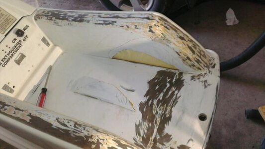

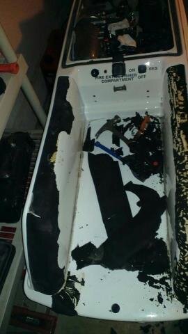

I got a LOT of the foam out, it wasn't soaked too far in from the bond line. ended up laying 5200 around the bond line around the back and hopefully that takes care of the leaking issue.
I was not planning to put stock bump gaurds back on and turf the whole thing (so i have a set of bump rails if anyone needs them). and i did not like that big ol lip sticking down off the back.IMAG0305.jpg So i cut it off.
I am planning on laying some foam along what is left of the lip and glassing it all flush.
