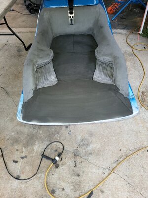

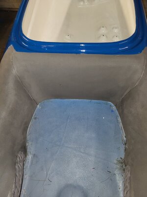

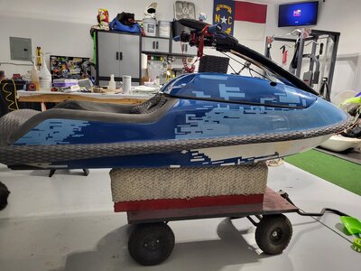

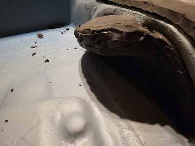

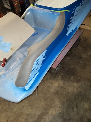

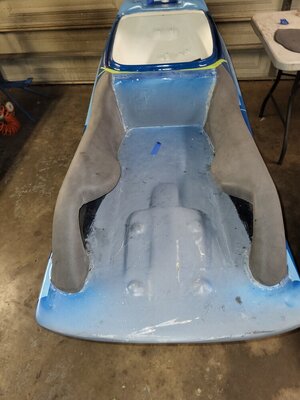

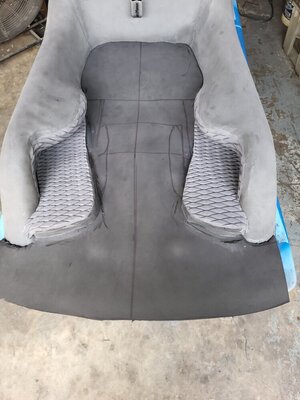

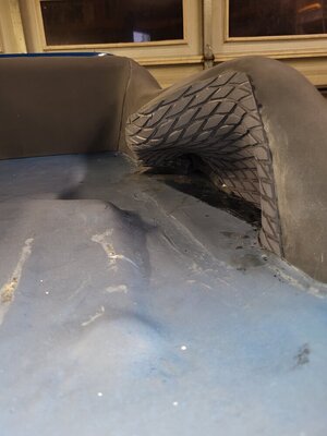

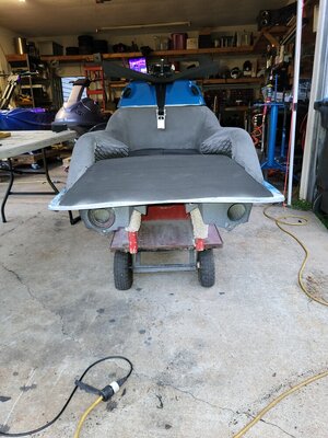

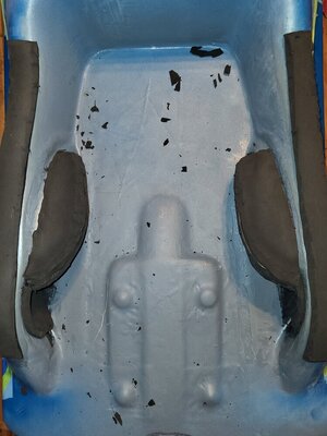

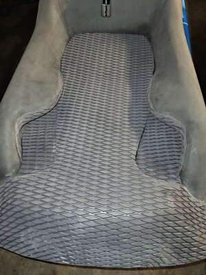

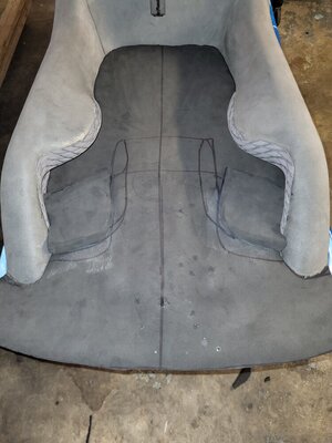

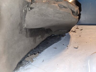

Here is how I turfed my superfreak. With the footholds it definitely helps to add extra padding around the corners so it gives the turf less curve to go around. I used smooth on the gunwales and footholds with molded diamond on the floor and inside the holds as well as around the bond rail. I use a combination of a harbor freight 3/8 belt sander, random orbital sander and a angle grinder with 2 inch twist lock fiber pads. I use exactly knives to cut the under mat.
