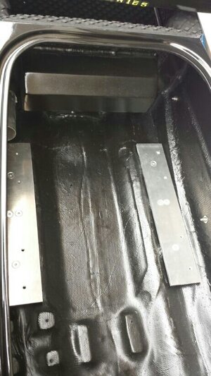

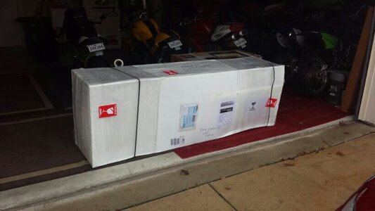

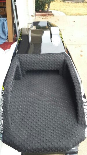

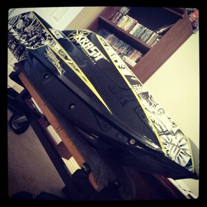

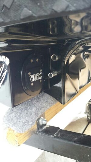

Well I finally received my new glass footrocket hull on Thursday and figured I would make a thread of my progress and any questions I have while building. First off I purchased the hull through Nick Barton. The service I received was excellent, he answered all questions I had asked within the same day. He was always good at keeping me updated on the progress and other information.
Onto the plans. This build will probably take over a month with my colorado trip coming up in Feb. I plan to put my 701 in it for now. I will be running a bpipe, h2o designs waterbox, 144 mag, thrust trim, stock tank, rrp pole, steering, etc. pretty much everything that was on my chan.

Looks good dude! Glad to see you getting going in it! Good time of the year, plenty of time to get it built before the warm weather

Take you're time man looks great got me thinking of krash now have to check out Zack and Jake in Daytona How's the fit and finish
