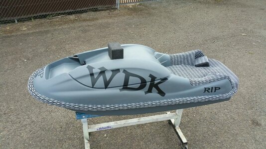

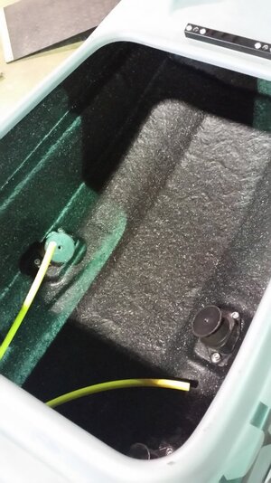

Hull is a Carbon/glass hybrid and around 70 lbs. It looks freeken awesome and feels very strong. It came with alum pumpshoe installed and new oem GP motor mounts, hood pin system, etc.
Here's just a few pics of it right now, and I'll have more pics later! Trying to manage college, working, and building a ski all at the same time so I can ride some before the lake freezes. Goal is to have it done in two weeks and be flipping in one. Let's hope I can do that!
