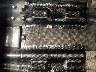

Here's a quick pic I snapped of the engine bay yesterday. I layed a layer of carbon over the motor plates just for extra security. I told DK Sr. what I wanted to do and he shipped me all the material and now they are doing it too on all of the Carbon Hurricanes last time we spoke. Now I'm just waiting on funds to get my pump and then motor back together and some new Novis....

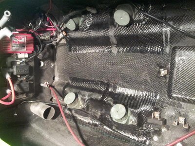

Here's a pic right after I laid it. I have never done carbon before and the material DK sent me was a breeze to lay and is strong as hell!
