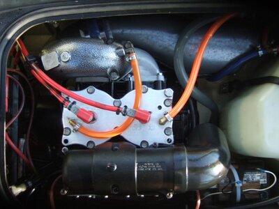

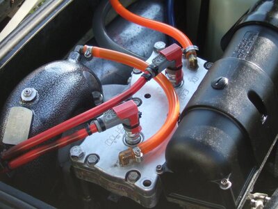

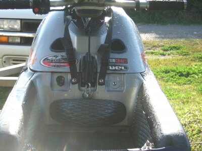

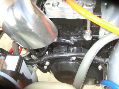

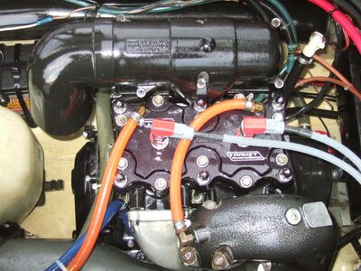

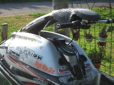

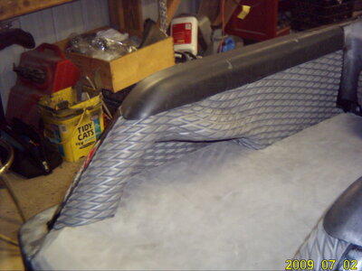

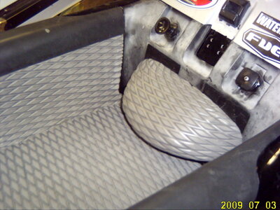

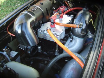

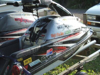

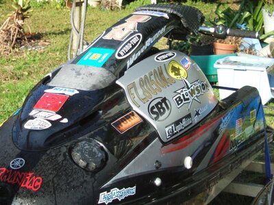

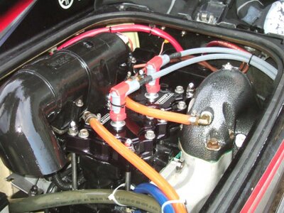

I can't say that I've done a build. A little here, and a little there.....
Bought 2 sj's (2004's) in Sept 2003. My wife's remains bone stock except for a b-pipe, primer kit and a jet-trim chinpad.
701 to 737
83mm Pro X pistons (Nuklear6)
Boring and decking (Nuklear6)
Ported: Cases, cylinder, exhaust mani, head pipe, intake mani.
Modified dome squish.
Kawi 750 pin bearings
1.5 needle valves
b-pipe w/mod chamber
75/135 jetting
Pro Design cool head, girdled, 185 psi (removed)
Msd enhancer
Shortened 2.5" stock pole
Wamiltons shortened turn plate (removed)
Riva HD 0-degree bars (removed)
Umi bearings (removed)
Odi rogue locking grips
Jetworks Flow control valve
Tom21 footholds for 25mm pad
Highroller ffh (removed)
Butti style Alum angle FFH
'93 kawi throttle cable
Worx 201 intake grate
Worx Dominator ride plate (cut to stock length)
(d-cut stocker got demolished)
Skat swirl 12/17 impellor
primer kit, removed choke flaps
removed on/off/res switch
jetsport484 limiting rope
cp watercraft hood straps (removed)
Jetmaniac stainless Ratchet strap
x-metal throttle trigger
reinforced tray

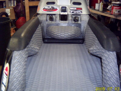

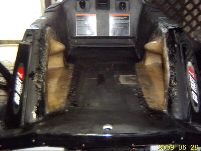

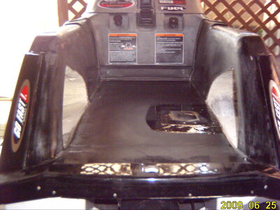

butti did the turf. (turfed myself after re-build. ACK!)
on my 3rd or 4th hd pole spring
Hull drains for '93 blaster
self-modded hood,(front airholes glassed over,opened up rear with dremel)(removed)
Superfreak Carbon Fibre hood and nose piece.
Watcon octane hood seal
snowxr (XR Tech) aluminum pump shoe (removed)
Carbon tech carbon fibre reeds (thrust innovations)
Jetworks "tee-handle" hi-low carb needles (removed)
Single rule 360 bilge pump + stock bilge (removed)
Added 2nd pisser at head install, but not dual cooling.
MSD plug boots and keepers (leg drag)
AGM battery
GP800 motor mounts (jetmaniac)
Self-modded chinpad
New-2-me dual 38's via Jetmaniac/Blue
Back to stock fuel lines.
automotive freeze plugs temporarily blocking original foam fill holes.(removed)
Glassed original foam fill holes.
Bilge broke. Replaced 360 rule w/500 rule. Stock bilge still operational
Installed 9/15 Hooker impellor (from AtomicPunk)...Skat going to impros
Installed 85.5mm bored nozzle (jetmaniac/#zero)
New pump seal (riva)
Back to stock pump shoe (riva)broke(Fred)
Removed Hooker. Re-installed Skat 12/17
Removed pro-design head. Installed ADA w/35cc domes (thrust innovations)
New stock impeller housing/wear ring (greater yamaha)
12/17 skat swirl refurbished at impros
Jetmaniac/JSS modded coil/wires
Jetmaniac/#Zero lightened flywheel
Installed new power cables (all)
OCD Solutions military bilge switch
Installed New OEM solenoid (greater yamaha)
Nearly-new mid-shaft bearings and seal (Aircraftsalz) another in from Sanoman.
Extra layer of turf installed in foothold instep...(25mm pad squishes over time)
Replaced UMI bearing set-up with OCD Solutions set-up via Jetmaniac. (removed)
New locking/threaded shaft collar via McMaster Carr. (removed)
Blowsion billet fuel cap via Sanoman!
Installed Freestyle 650 stubby pump cone (removed. Back to stock)
Cold Fusion steering system (jetmaniac)
Blowsion "fat in the middle" straight bars (jetmaniac)
Carter B Tubbies. Installed by Carter B.
X-Metal stainless pole bracket. (Jamie)
Cold Fusion Hood Hooks. (Jetmaniac)
Another stock pump shoe (Jetmaniac)
Another Watcon hood seal (Jetmaniac)
All new Alum/silver hardware.-pissers, bilge fittings, tow loop fittings etc...(Sanoman & Jetmaniac)
2nd 500 Rule bilge. (X2 Frank)
Slightly modded hull. Cut off rear brakes.
New Steering cable. (Jetmaniac)
Paint by the Hastings Guys. Unknown color. (locals)
New OEM start/stop/kill switch 7/23/16 via (Jetmaniac)
All new power cables 8/2016
pics..(newer 2015 pics pages 10,12 and 14 of this thread)
