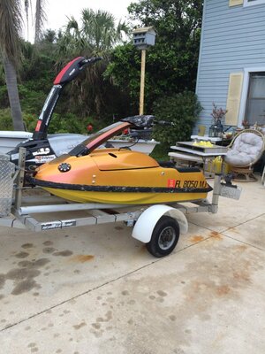

I removed the stubby pump cone and installed the OEM one this morning.
Also installed the flame arrestor and ran into a problem. The interior hood drain hoses are in direct conflict with the flame arrestor. Had to cut one shorter and re-direct it. It will work, but the two hoses have to go different directions, so they're not neatly zip-tied together as I had them. Boo-Hoo.

I ran into the same issue when I made a liner for my rn hood, I ended up I believe having one tube directly behind motor and the other in front
FlightPlanDan
Don'tTrustAfartAfter50
I only had to cut one of them shorter. I thought about cutting it off completely, but it's the one over the carbs...and that seemed to defeat the whole purpose of the tube.
It will now dump directly on the battery. Not sure how I feel about that, but.....we'll see.
The other fits neatly between the stator cover and fuel tank.
It was a used hood at a good price. I can't complain about my own lack of foresight on this particular issue.

Pull that vent tube out and glass the hood closed in that spot. Relocate the tube in front of the flywheel cover next to the other tube. Then you can zip tie them together again and be happily content knowing you are sano again

Took it for a burn after work today, and I must say that.....I think that, with a lot of help, I may have created the perfect surf ski! (less some nose rocker)
I'm not thru the break in yet. I intend to fine-tune after. But it hits great and handles great. Almost too good. Can't break it loose like before.
I yanked out the stubby cone and went back to the stocker, as my builder suggested, and it actually made a noticeable difference for the better.

Carbs finally dialed in. (a while ago). It's a wonderful thing. The ski is giving me all that I can ask of it.
The carbs were an issue because, if you go WAY back in this thread, you'll find that they are a matched pair of Mikuni 38s, but off of an old wave raider.
There are differences when compared to stock SJ 38's.
#1: Threads on the needles. The SJ carbs have coarse threaded lows and fine threaded highs. The wave raider carbs that I have are ALL coarse threads. This makes tuning completely different from other similar set-ups. The number of "turns" differs from the norm.
#2: The taper on the needles is much more severe. This REALLY makes a big difference, specifically with the lows. Normal SJ's are around 1 turn out to start out. I ended up at half of that, and could have gone further, but better safe than sorry.
Funny. I can't believe that I didn't foul plugs with the incredibly rich settings that I was running.
Anyway, I learned a lot and the PIG runs great.
