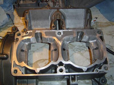

Wonder what effect would you get if you ground down & flattened out (with devcon or something) the divider in the reed holder plate on the intake?
(top piece in pic)
I think you mean the piece in the center that splits the airflow out to each side of the manifold?
I wouldnt want to grind that down flat... that would create a major obstruction to the air flow through the manifold. If anything maybe slim it down a bit, but you would want to keep its general shape intact I think.
Or did I misinterpret what you meant. I think grinding the sides down slimmer could help but grinding the ridge down would not help...
