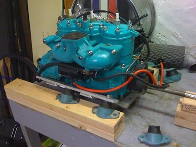

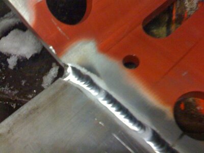

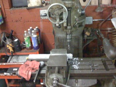

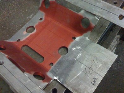

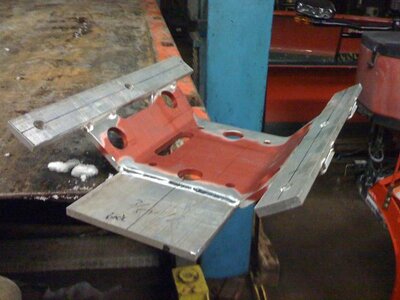

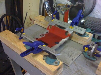

Got to spend some time today on the motor plate. The idea is that I start with a JSH Alum motor plate and add the extra parts too it. This way I can build it again and be able to build it for other people. The sides I just tacked on for now till I am 100% sure its right. The rear part was fully welded but I had to grind the top flat.

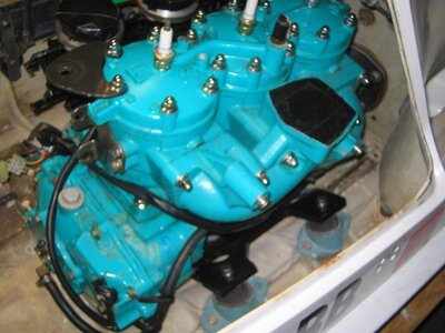

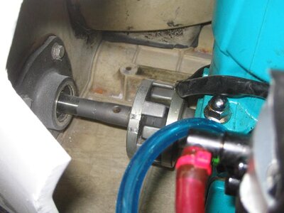

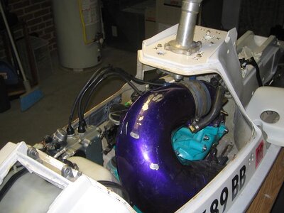

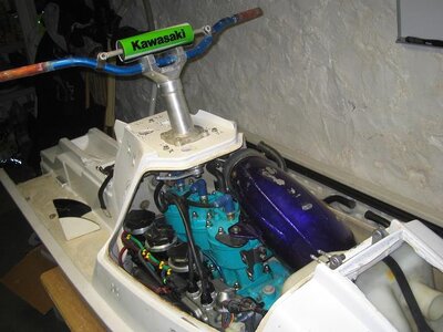

As it looks right now I will need to take a inch or 2 out of the stock shaft, but I still need to spend some time fitting everything in the hull before I cut the drive shaft.
This thing looks like somthing out of Star Trek!!
