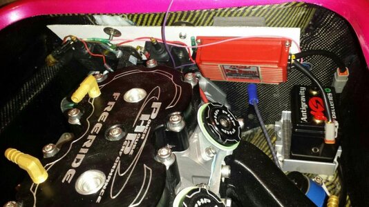

Cold fusion battery box all set.

hmmm i really like it
is there where the battery is designed to fit on your hull? of did YOU decide to mount it there?
Im running a full size battery n it takes up a lot of space in front of the motor
The hull was designed for the light weight battery to be there. Super easy and outta the way.

What do you guys think of the way we mounted my total loss board.
We made a fiberglass board to start it. We organized the total loss on the board. Instead of drilling through the firewall, cause who wants to drill more holes in their ski, we used the hole from the hood latch and then epoxied a bolt on firewall as a second mount. Used that as a mountimg point. I have padding behind it for security. Everything isnt fully wired in picture yet. Working on it. My job is getting in the way of my build. Lol.

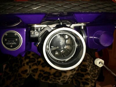

You posted a picture on instagram of the scupper area, it looked like one of the scuppers was facing up? Did i see that right or was i drunk?
Haha... its a reflection. If you look to the right of pump u can see the second scupper. Just a very shiny finish on the killer paint job!

I know a lot of people do it (ive done it) running coil next to the brain. Why not swap it for what looks like relay location and keep both coils away from the brain like MSD suggests? I would like to see sturdier plate mounting if you are going to be flippy and rolling big. Just a suggestion, looks good saw it alt WF's

Its pretty stout it the same glass we use to make the rocker kits and padding behind it helps also and wont let any rub marks get to the hull

Looks nice, please put a layer of carbon on that glass TL board :) In that carbon/kevlar paradise bilge, a white glass plate is the first to strike your eyes.
And for the TL brain to close to the coils, I've been running mine in a enclosure with "no" space, and the RRP enclosure does as well. Really nice color combo, damn can't wait to mine is getting made!

Thanks! And yah haha. We are making one out of carbon soon. The glass is a template. We made 2 glass ones. To see if it would be suitable. We gotta buy some carbon. Just dont wanna buy a crap ton for that little amount that we need. Its coming along nicely though!
