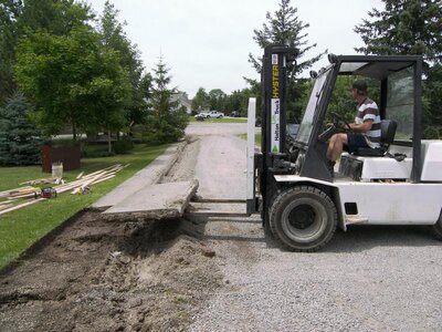

The Yale is yellow, but needs to be repainted badly. So far I've had to figur out the wiring for a 12v conversion, remove and reinstall the starter, clean the fuel system, and get a rigged electric fuel pump working. The brakes don't work, yet. As you can imagine, this thing has sat unused for awhile. The clutch frivtion disc is also stuck to the flywheel, so I have to pull the top of the tranny off to get it freed up. I drove it for a few minutes, and not having powers steering suck big donkey balls. I'm gonna have Popeye arms.
