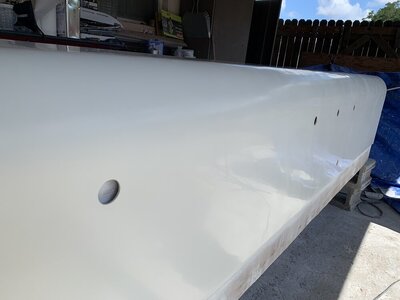

I’m currently working on my own plug, using tried and true hand methods as seen on this wonderful forum. It’s work.
I keep thinking, I could probably build tooling or a system to make test hulls faster.
I was drinking with the boys tonight and shared my thoughts. I’m convinced after seeing designs and taking measurements I’ll want to try a bunch of different design options. I have no issue throwing away test hulls. I have a bunch of different thoughts on the underside and rear deck. Plus the width where the decks meet, that flare is interesting.
One friend said injection moldings, another friend said cnc cut the hull. An acquaintance said his ski was built on a cnc’d plug.
I was thinking, 3d print maybe?
I don’t know dick about material strength but I saw they 3d print boats.
I wonder if anyone has done it. If you were printing hulls you could test designs much faster.

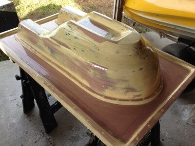

The BabyJet was hand built and any tools I used were hand made. This was quite the cumbersome process. It's all documented here...
Wooden tooling sucks....

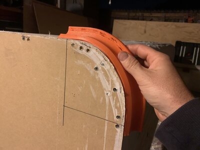

Since then, i have began using my 3D printer for these jobs which much faster are more precise results....
This radius used to take days for me to shape by hand, but with the 3-printed tool, I completed this plug shape in an hour.

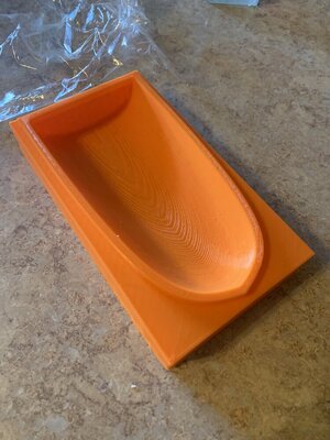

I did however 3D print a mold for paper machete to teach my daughter about how her BabyJet was built.
So I do know these are viable methods for building boats. 3D printing the mold saves the work and materials of building a plug and building a composite mold. What I do not know however is the impact of heat on the mold, as I haven't use this method on a larger scale or with exothermic materials.

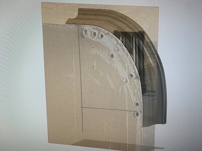

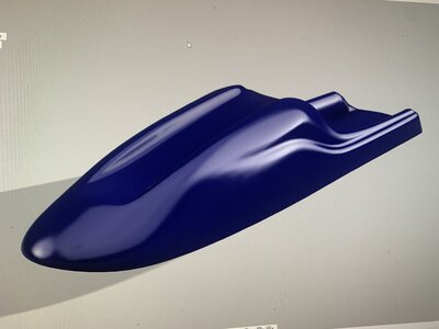

This here is a 3D scan of my Kawasaki X2. The price? $25, using a gifted Xbox kinect sensor, a $25 USB adapter and free software.
Imported into Fusion 360
This is my end point for Surface modeling. I probably have the skills after the modeling is done, but I can't move forward until I can learn to model better. Fusion 360 is free for hobby use. It is incredibly powerful. I use it for all my modeling for 3D printing, but it also includes G-code outputs for 3-axis CNC machining if you go the router route.
The hardest part of all this is figuring out the steps from start to finish (evolution of skills and equipment) and I got stuck on surface modeling. However, since then, I have realized that the solution is a hybrid plug process, where I print complexed parts of the plug, such as the hood seal and hinge assembly, while leaving the rest of the boat for more traditional methods, such as pump tunnel splashes and printed tools for chines / bondline shaping, until i am ready to move to the final step of fully 3-d printed (probably CNC routered, actually) plugs.
I hope this post answers most of your questions. Best of luck.
