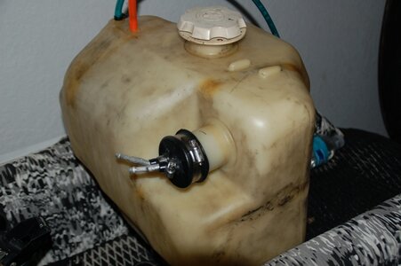

I have the perfect solution. it sounds crazy but it works. its what i did on my ski. however your going to need a stock SN fuel filler with cap.
I pulled the pickups from the top of my tank, then i carefully bent a 90 degree angle in each of the fuel pickups (the internal part) and installed the fuel pickup fitting where the stock filler used to be on the tank. installed a hose clamp and called it done.

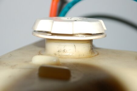

then i took the SN filler put it in ice cold water, then put the top of the tank in some boiling water let them sit for about 5 mins and shoved the stock filler into top pickup hole in the tank. its a tight fit but once its in....its in.....seals perfect.
so my pickup lines run out of the back of the tank (hole near the waterbox) and are hidden from sight. and I have a perfectly functional filler on the top of my tank.
Its a really clean setup and best of all you dont need to cut/seal......none of that crap

id be afraid of kinking the pickups...how far down to they reach with the bend?
just keep the bend smooth and give it a decent radius.....you'll be fine
mine reach just as far as they did in stock form......i lowered my stock line a bit (my reserve was too big)

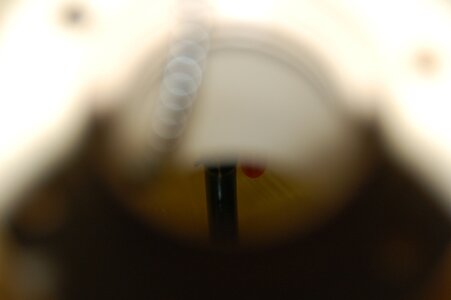

never realized how dirty my gas tank was.......
also there are some scratches on the filler (don"t mistake them for cracks)
