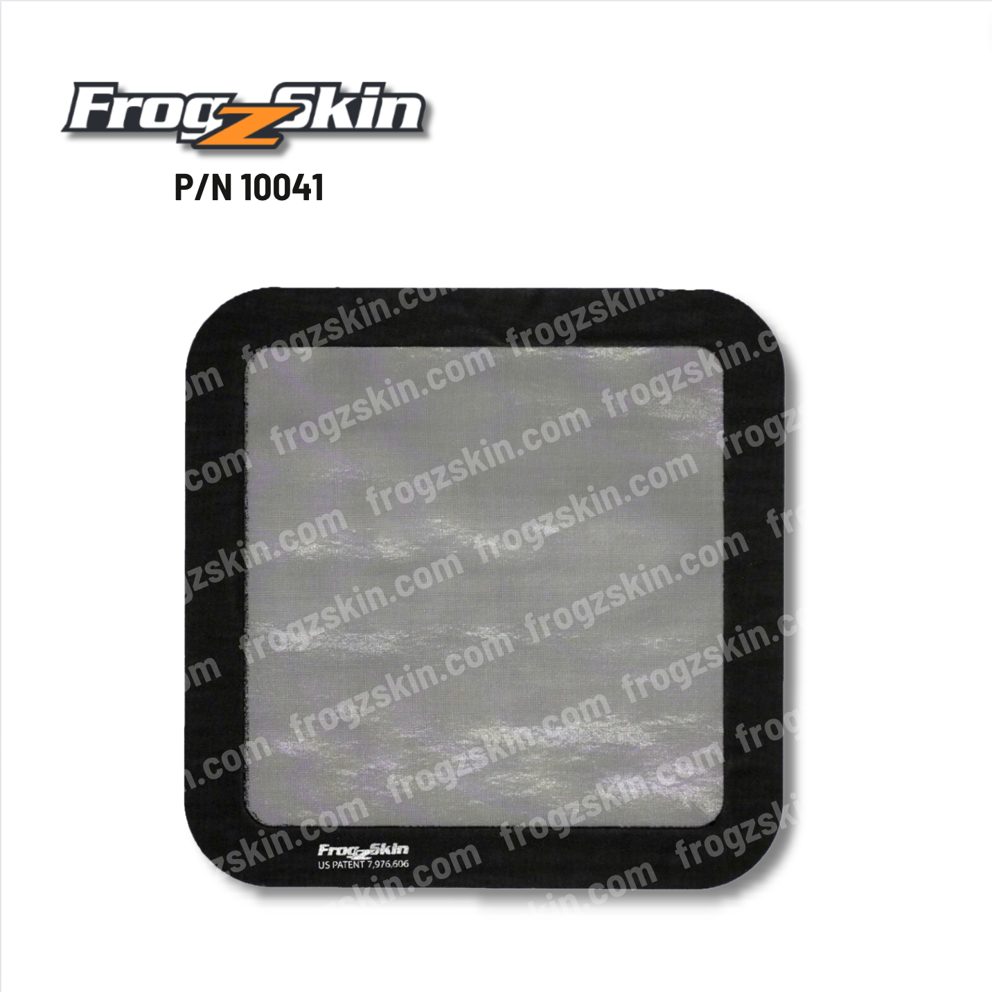

Holes in Dash?
Do people drill holes in there dash and put those frog skin things over them to keep water out?

Fresh build: I have a Dasa 970 with dual 46s-Edge FR. The deal is it has a Blowsion pole (does not let much air in). I cracked the hood and after feeling how much it sucked the hood down when you blip the throttle it confirmed to me it could use more air. I am considering drilling a couple 1 to 1.5 inch holes in the Blowsion handle pole for more air flow and cover with Frogskinz . Has anyone done this and if so what location on the handle pole. I consider the hood scoop.. but also ride the surf… really do not want to do the scoop.
Fresh build: I have a Dasa 970 with dual 46s-Edge FR. The deal is it has a Blowsion pole (does not let much air in). I cracked the hood and after feeling how much it sucked the hood down when you blip the throttle it confirmed to me it could use more air. I am considering drilling a couple 1 to 1.5 inch holes in the Blowsion handle pole for more air flow and cover with Frogskinz . Has anyone done this and if so what location on the handle pole(I am considering underneath/bottom toward the back of the pole) . I consider the hood scoop.. but also ride the surf… really do not want to do the scoop.
