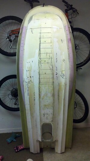

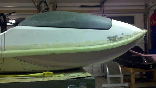

Just finished shaping last night . Plan on glassing shortly using 14 oz 8 hhs S glass. I guess it's a crap shoot as to weather they will ride or not.
Forgive me Father wydopen for I have sinned .... Please be lenient if it fails .... I have already suffered enough .
1.5 shorter and little more rocker in the rear. Nothing drastically different that have not been tested.They Just has not been tested in conjunction with nose and rails. Thanks for the complement .
did u just raise the rail line (outline) on the rear??..im assuming the intake track and ride plate and stuff is all "flat" still?...
weight?
