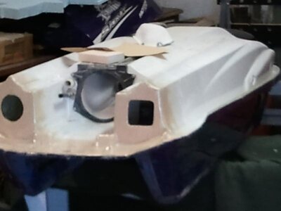

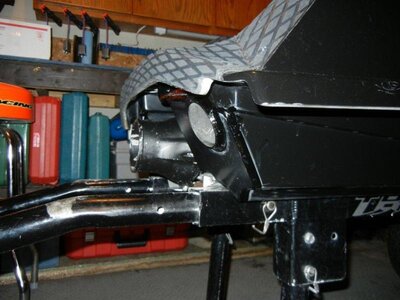

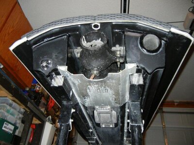

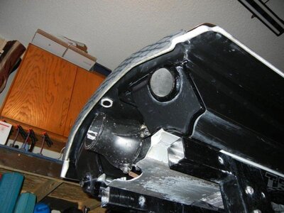

I cut mine straight for now. Gonna ride it for a bit before i go further. If anything, i might scallop the chines... Its a 2008 btw... Heres a couple in process pixs... Just mocking stuff up... Still need to final sand the epoxy used to seal the marine filler... Then paint
