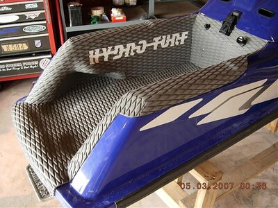

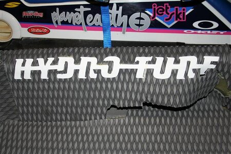

Ok, so my first mistake was buying a precut kit. Next time I'm just getting sheets. This has been way to damn frustrating. I was literally so pissed I was throwing crap around the garage, and its not even my garage.
I installed the front panel no problems. I've turfed before (an X2) so I know what type of glue to use (DAP gel) and to let it sit for a few minutes before applying turf.
Anyway, the way the side pieces sit, the damn Hydroturf lettering sits on the curve (top of the tray), rather than on the side. This is causing a friggin' nightmare because the damn numbers won't stay down (yes, I taped them before applying - and then taped them again and again trying to keep them down). I have no choice now but to let it sit overnight and hope for the best. I am not optomistic though and I have a feeling I may end up tossing these side pieces and buying a sheet. But I am not sure if I did something wrong or if this just sits this way.
This kit comes with about 10 pieces, no directions other than how to glue. I found something on PWCToday that showed what each piece is for but I am flying blind on this project and seriously FUBAR'ing it. Any help would be greatly appreciated.
(Yeah, I think I f'ed up the turf inside the footholds as well, but I'll just patch those up with extra turf. It will look like ass, but its in the footholds, so it won't be as obvious). Note that the bottom piece isn't glued down yet - its just sitting in there.
