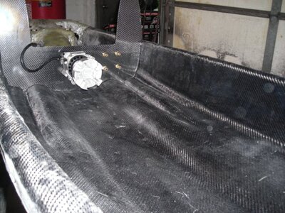

OK, well we got a bit more progress on the boat over the weekend. The exhaust tube and scupper tubes are now in place, as well as the drive shaft tube. We also have the motormounts glassed in. As you can see in the pictures 24-7 uses a much larger motor mount than the superjet one. Here are some pictures of the progress. I also managed to snap a shot of the prototype X-Metal water box holder he has been working on. :sneaky: Also dont mind all the dust on the hull.

Thanks for all the complements. We hope to have the ski over to Ian at Stuck Up Sticker Co. shortly after christmas. The ski will then be headingto Daytona and then I can finish the build. As for the motor mounts, yes they are aluminum but I am not sure I can share the bonding procedure. I will check with Mark on that one.
