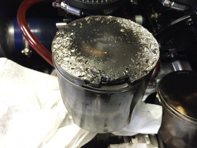

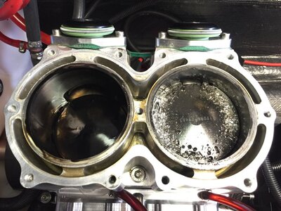

This is what my Dasa 1200cc 7port looks like after 18h from brand new;
My ski setup is;
*Dasa 1200cc 7port 94mm (need to bore it up to 95mm)
*46cc head dome
*48mm Dasa Carbs
*MSD Enhancer
*160mm pump
*BR8es sparkplugs
*Running 98-RON pumpgas
My Dasa 48mm carb setup is;
Main: 130 1/2 turn out.
Pilot: 120 1-3/4 turn out. (Dasa told me that I need a 135)
Around 70m above sea level.
Around 20°C in air temp normally.
1/42 oil ratio (2.5% oil)
So basically.. My Builder tells me that the jetting is spot on the the Head domes is the right size for pump gas (46cc = 185psi). He tells me that he thinks that heat and dilatation made the piston ring clip the exhaust port and cause this, some how..
Dasa on the other hand tells me that the Pilot jet is way low and the the 46cc head domes equals 205psi and need racefuel and thats why the piston looking like it does. Keep telling me that detonation did this, but my eyes can’t see any detonation signs on the ”good" piston though..?
So im like in between and dont really know what to do..
I picked up some bigger Pilot jets and 48cc head domes today, but I dont know if its gonna solve the problem.. I guess the time will tell =/

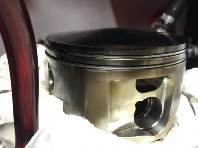

@JonasOlson take a better pic of the good piston so we can see the dome better. It looks very black but its hard to see. Also a pic of the domes. Are they black to??
Sent from my SAMSUNG-SM-N920A using Tapatalk
Here is some pics of the "good" piston and the domes;
I have read some about the thing called "piston wash",
My piston wash aint looking that good though..
Or what do you guys think?
Then Detonation that Dasa claims be the reason, I cant see any detonation..?
Blue
Judging your cheapness
St Cloud Florida
Its lean. Domes shouldnt be that black. Barely any wash on the piston. Richen her up.

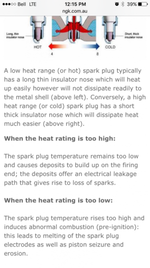

I've seen this before on here somewhere and thought it might help you.
Sent from my E6853 using Tapatalk

I have 6 Dasa pistons out of 4 different Dasa motors all have exactly the same damage.
It's 100% caused by detonation.
It brakes the ring land on the exhaust side then ring snags port and rips it up like you see.
Stop looking at 205 psi.
That's bull $hyz number that means very little in big picture.
Dasa runs 200+ deg exh port.
Mix that with 205 psi and that's 16to1 comp.
not gonna run on pump gas.
Your low speed jet is out 1-3/4 turns.
That means low speed circuit is lean and your flooding fuel on bottom end.
Take your low speed screws to just under 1 turn.
If it lean bogs u need bigger pilot jets
Low speed screws are only!!!!! For idle fuel adjustment.
Idle only.
So your 1-3/4 turn is giving u a pig rich idle and that's covering your lean big with residual fuel.
But when it's ramping down from high throttle settings it's deadly lean.
