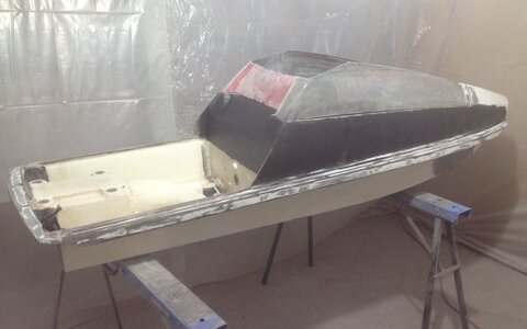

Awesome, there is a cheap sn hull in my area I want to pick up and do the chop chop to it!
Most SN builds are just the same old rocker and chop...
This one is hella interesting. Keep up the fantabulously clean work!
Sent from my SM-G920V using Tapatalk
Subbed, what's your plan for footholds/sides of the tray?

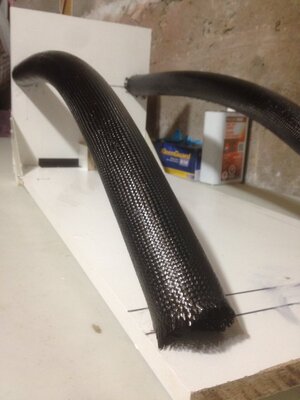

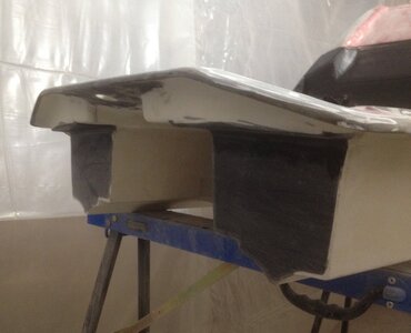

The sides of the tray are going to be more 19oz carbon. I'm going to make more flat sheets and then cut them into shape and put a slit in the bottom tubes. There will be 10lb foam in the tubes for strength. Then maybe rickter holds attached by some slash cuts in the carbon sheets to move the holds forward and back. And the tubes will punch through the fire wall/dash for strength.
