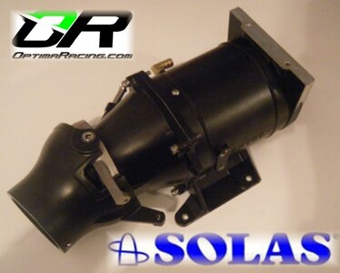

There is already a really nice 140mm/12 Vane Kawasaki version. Very nice piece, includes the reduction & steering/drop nozzle setup. I sell quite a few of them and have used one with great success in a limited application.
OptimaRacing
Jet zoomers
Not trying to thread jack, but there is a Solas 12-Vane pump for Kawasaki's. Great pump, I've had excellent success with them.
Use the one that comes with it. They are different sizes (believe). I have not pulled my pump yet, but from the looks of the cone that came with the solar 12 vein, it's much larger.
yea this is what you need for your setup
140 to small 148 to big
just need to replace the seals and install new ones on this pump and your bearings are more than likely fine press in the new shaft and done reinstall all your impeller housing and pump nozzle .
the spacer ring i already include with this price at $525
