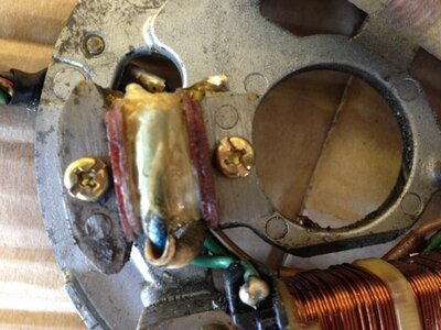

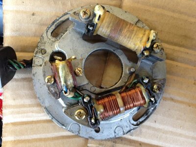

Problem solved!
After getting a new (used stator) things were looking good!
We tried measuring the resistance in the different coils, and found the pulsar coil to be off tolerance!
After trying out with a new one things worked smoothly!
BIG thanks to all who came with ideas to fix the problem, and a special thanks to Chris from ATP for the correct answer to the problem :eek:)
--> IMG_1690.jpgIMG_3614.jpg This is the bad boy who caused the problems!!
