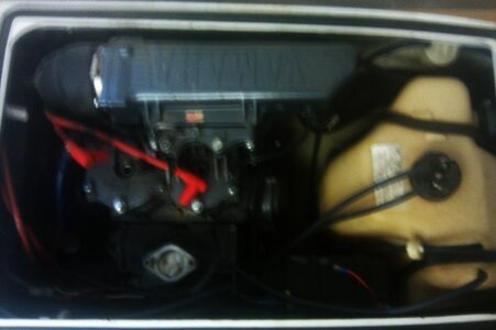

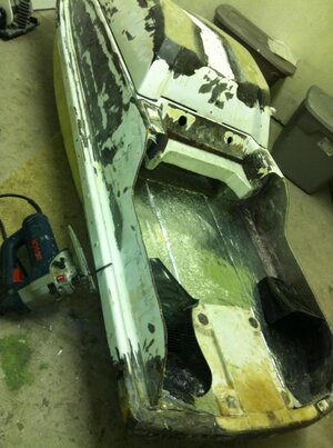

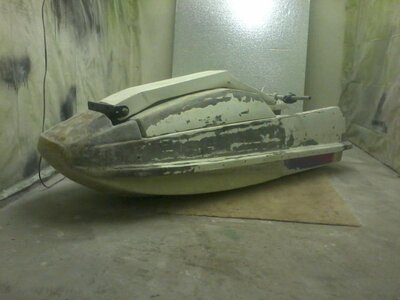

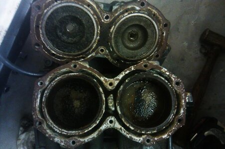

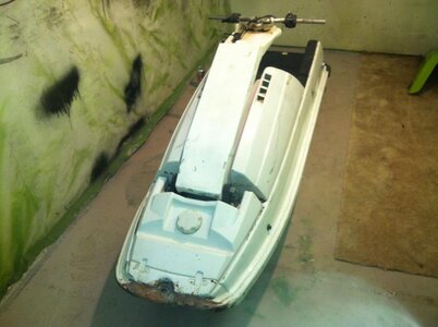

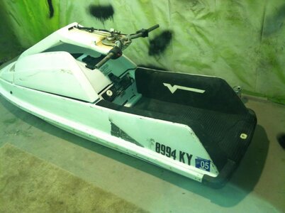

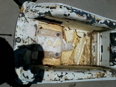

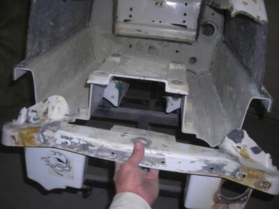

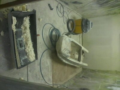

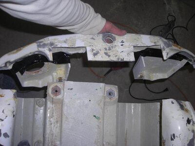

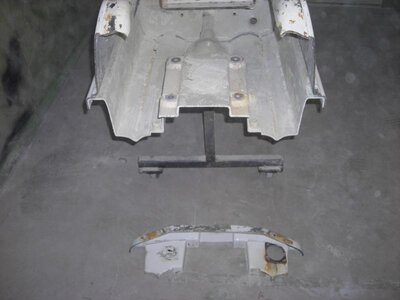

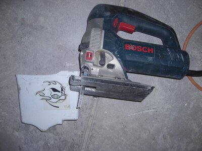

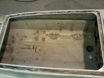

My buddy gave me a complete stock SN hull, missing a carb, but had an ac racing handle pole and a top loader. Motor was frozen, so I decided to tear it down.

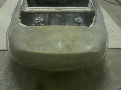

I first rockered the nose, and cut 3 1/2 off the back of the ski. I shaped and made tubbies. Put a front foothold in through the motor compartment. Cut the hood down. Moved the steering forward 6". Lowered and widened the tray. Molded adjustable footholds. Put together a nice motor. And more.

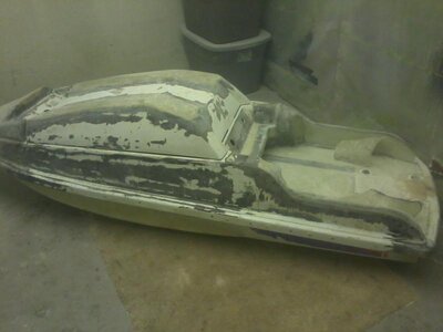

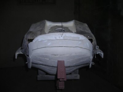

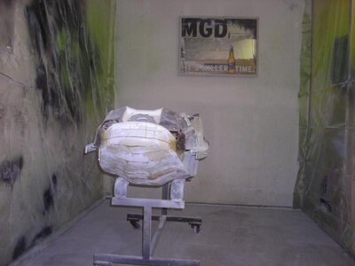

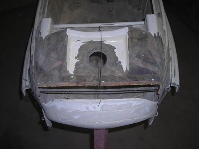

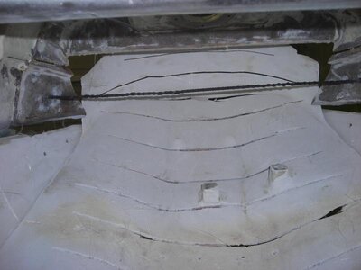

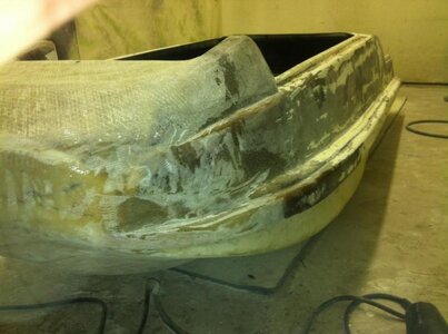

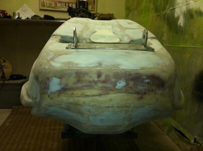

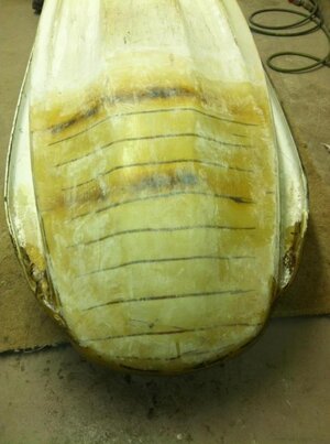

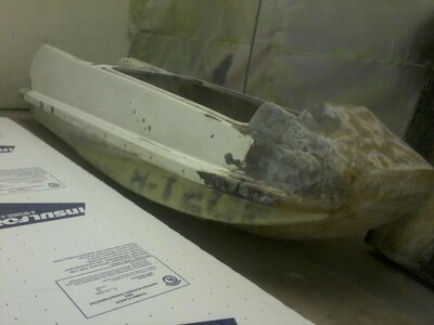

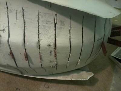

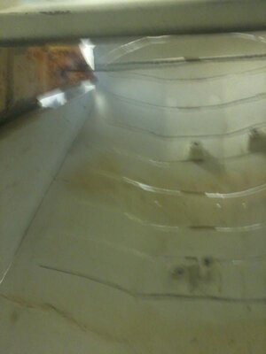

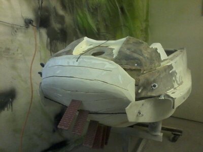

I cut a bunch of slices and pulled the nose up with wire and wedges. Then I pulled the sides back together by twisting up wire. Then re glassed it back togehter.
DSCN3353.jpgDSCN3380.jpgDSCN3352.jpgPhoto187.jpgPhoto185.jpg DSCN3351.jpg Photo201.jpg

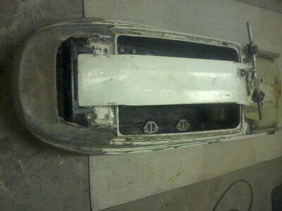

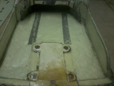

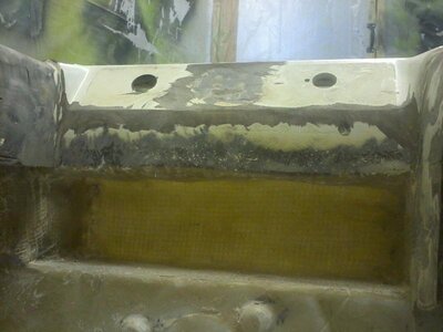

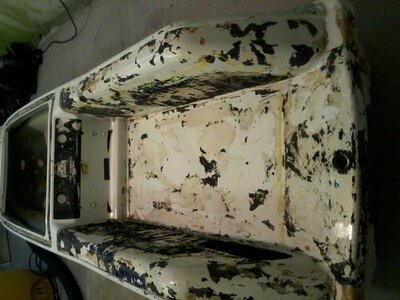

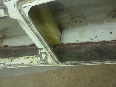

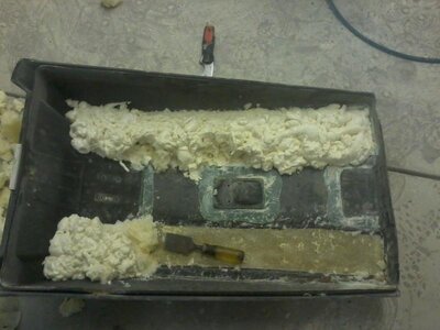

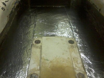

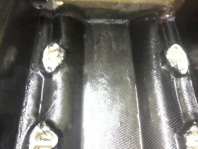

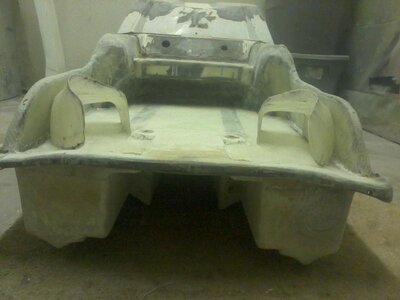

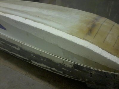

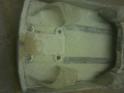

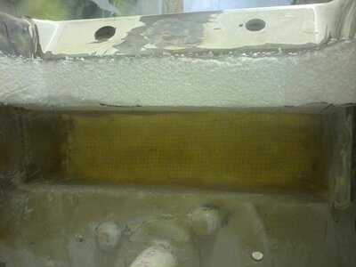

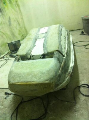

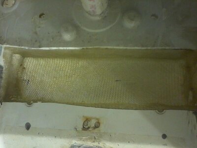

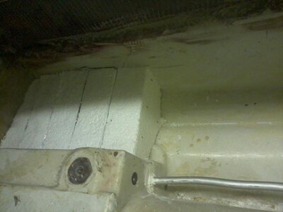

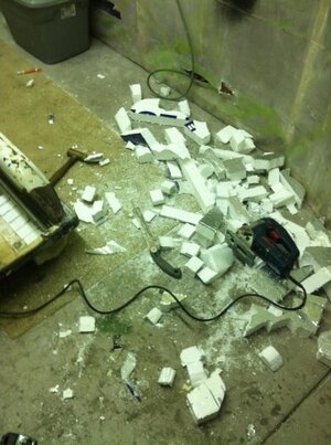

Filled rear tray up tight with styrene foam and glassed in. Side rails have 1/2 foam. first layer of glass connects from wall to inside wall to inside wall.
Photo349.jpg Photo352.jpg Photo357.jpg Photo364.jpg Photo367.jpg Photo371.jpg Photo387.jpg

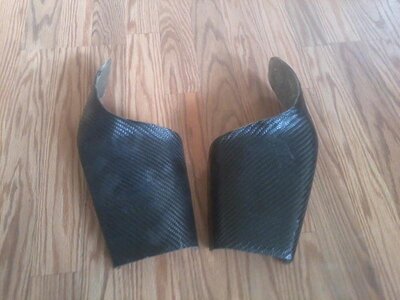

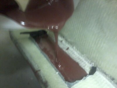

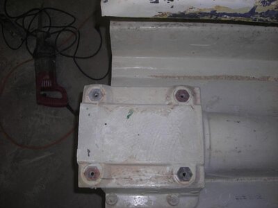

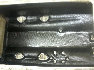

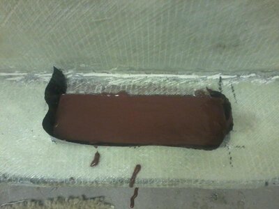

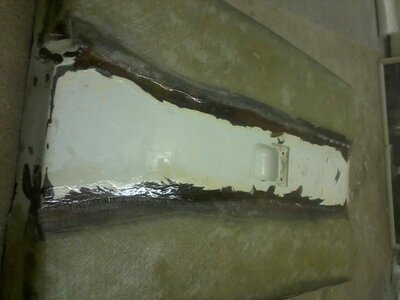

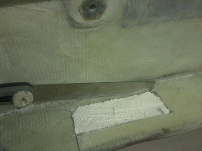

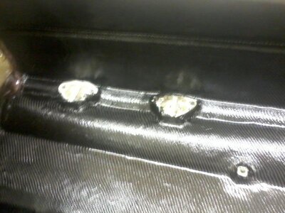

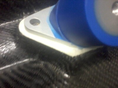

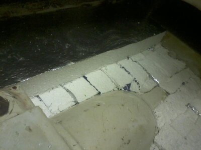

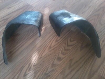

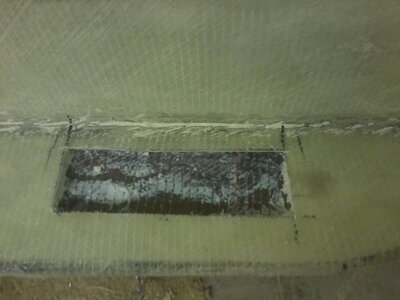

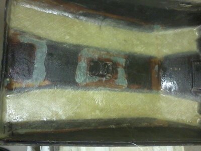

Made a mold of Stanton's Footrocket footholds. Then put a layer of carbon over the top. Then I cut out a rectangle where I expect it to mount and poured resin and microballoons into the side rail to make it solid. Then glassed that back in. This way I can move the footholds around after installation, and no way for water to get in.
Photo437.jpg Photo427.jpg Photo443.jpg Photo429.jpg Photo123.jpg Photo121.jpg Photo428.jpg Photo385.jpg

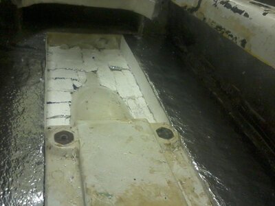

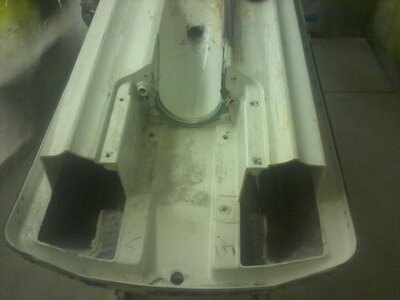

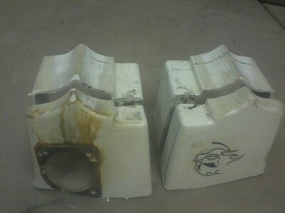

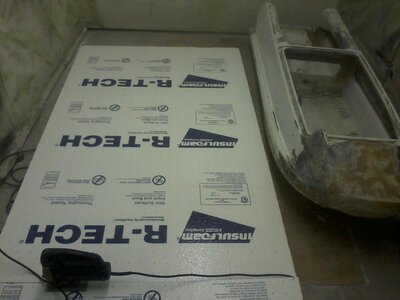

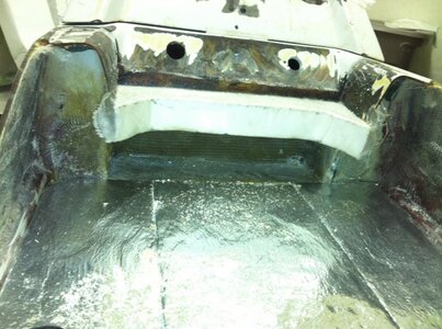

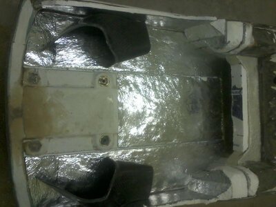

Shapped and made tubbies out ridgid foam. Glued on and glassed in. Extended tray forward into motor cavity 2 1/2". Molded pocket for front foot.Photo315.jpg Photo316.jpg Photo302.jpg Photo300.jpg Photo327.jpg Photo343.jpg Photo387.jpgIMG_1231.jpg

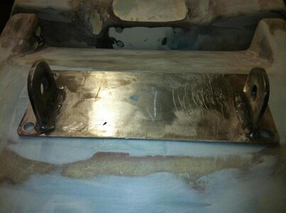

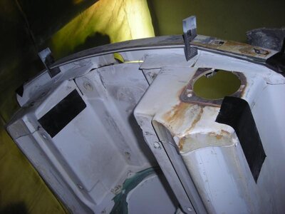

Moved steering forward 6".

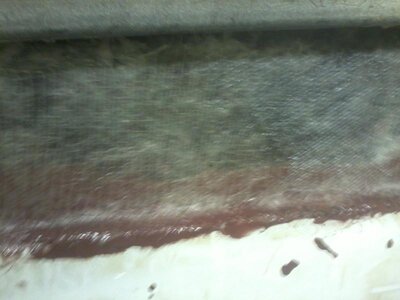

Filled bond line with microballoons. Added more glass to sides for strength.Photo324.jpg

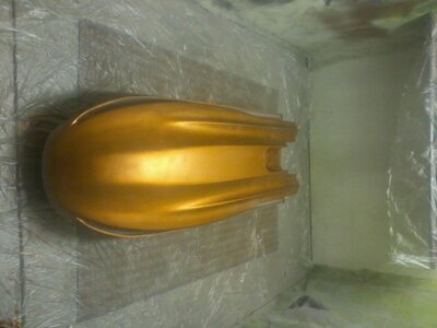

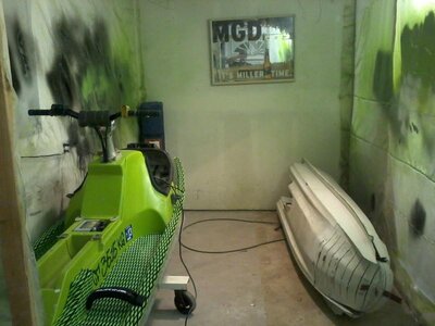

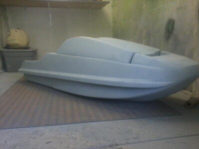

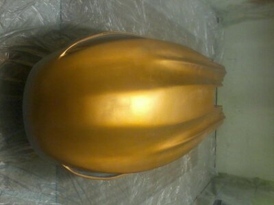

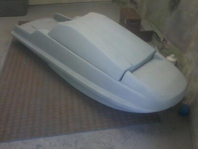

Primered and first paint color which i didntlike and repainted.

Thank you for comments, It is an AC racing pole I thought about cutting it -3" for a while, but moving everything forward seemed better for the handling of the ski. I did make a custom bracket for it that lowers the profile where it mounts. I dont like the copper color, I think I am going to paint it orange tonight. That was the original plan.

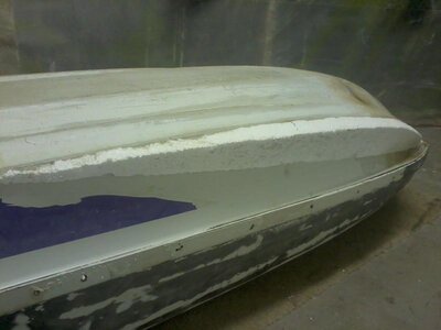

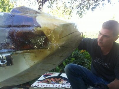

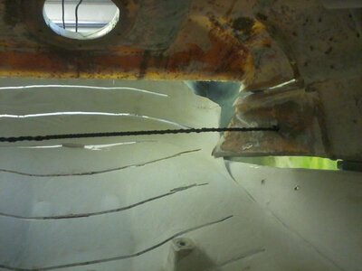

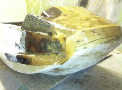

attachment.php

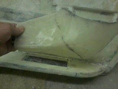

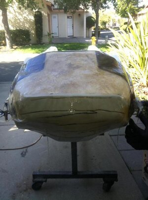

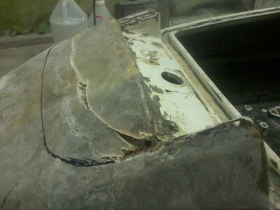

In the last picture you can see the two burn marks where I tried at first to use heat to make the rocker, but I didn't want it to have a 3 stage rocker so I cut slices instead. I left the last 1" atached so that i would bend but still stay together.
