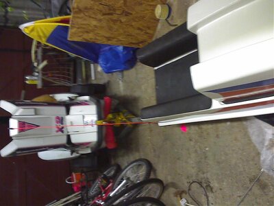

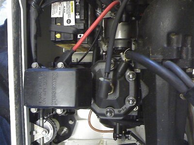

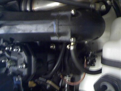

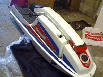

So nice to get a reply, many times you go on forums and wait weeks for even someone to view, as regard to fresh fuel, it has never had fuel or oil in the tanks, the closest this ski has been to water is the rain on the garage roof
Pics
Not the best pics, but hey its only an old dinosaur!

It is probably to late now but I hope you premixed the gas and bleed the oil pump of air. The oil in the gas is helps it break in.
Nice Ski!

Hey I had that same 300 ski new in 1988. Disconnect the oil injection and run 40 or 50:1 premix in it. Those old oil injection systems were total junk. I promise it will blow up. Run premix and no problems. I also broke a crank on it also from jumping and the rev limiter not working correctly. Where did you find a 300 never used?
Think your post has confirmed it, now I need to get a oil block off plate/kit!
