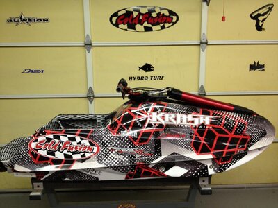

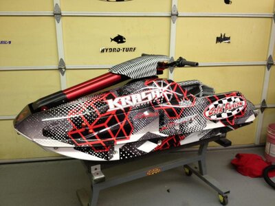

We debut ours last weekend at the surf slam, Nick took home best trick with it
and it looks like Matt and a couple others rode it as well
we will have at at the world finals as well

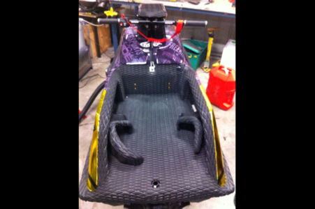

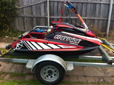

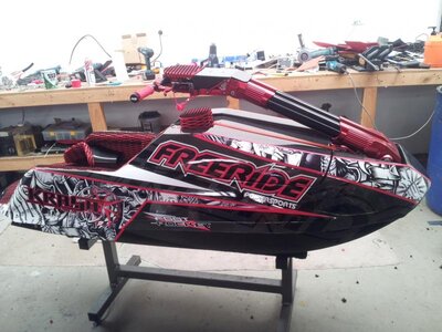

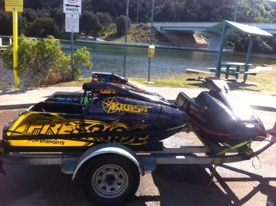

Here's a few pics of the last couple I've done.
Assemble is reasonably straight forward. A little more time consuming compared to a rickter as you have to fit the pole bracket, hood hooks and prongs, and a few other little bits and pieces but its no big deal, and all part of setting things up the way you like it. Like any a/m hull the most imprtant part (imo) is to take the time to get the pump shoe and pump lined up perfectly, once this is done right everything else goes together alot easier.
Lots of options on how you like your footholds, ride plate / tail plate lengths, tubbies, engine position etc etc. al of which can be adjusted at any time.
I have been riding a footrocket (flat water set up with a dasa 1100) for about 9 months. They are quite neutral to ride, lean back the nose comes up, lean forward the nose goes down. As already mentioned they are very light compared to some other hulls on the market. They turn really well and the sponson and fin options enhance this for the more aggressive riders. Flips and rolls are a breeze. I would love to see someone with some serous flat water skills put my ski through its paces.
I still went with a JB1 for my new surf boat, as I find it easier to ride in big surf or on messy days. However I am most likely going to build myself a "all rounder" which will be a foot rocket with a 850 for smaller surf and/or more aggressive Ariel tricks. And it will still be a very capable flatwater boat should my 1100 be off the water for maintenance.
Here are some pics of the last few skis I have been working on. One is a full carbon Kevlar footrocket with a 1200, the next is a glass footrocket with a 10mm stroker dasa 1100, and the last one is my new surf boat, a JB1 with a 701, msd TL, ada head and b pipe (this thing is proving to be a heap of fun!)

The carbon kevlar 1200 (which is a surf lay up) was a 30.8kg for just the hull from memory (70lbs). and we wieghed the completeski and got 117kg (258lbs) rtr, this is with a big lead acid battery it will be down to about 113kg (249lbs) once we fit up a lithium unit. Pretty light rtr given the extra wieght of the 1200 engine and 148 pump. The same ski in glass surf lay up would be about 8-10lbs heavier.(nick may correct me on this).
