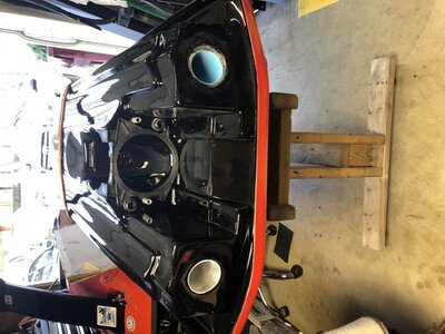

The build: I got started on it Friday and worked the weekend doing some changes.
I decided to take the pad off the tray bottom cause it was a little hard. Guess I’m used to HT padding.This turned out to be a good thing.l discovered that all 3 footholds were just bonded with rivets and some sort of 5200 type sealant.So l sanded and cleaned all the areas where the edges of the holds made contact with the tray.Laid some carbon fiber 2” and 3” tape over all the joints.The pics will reflect what l did.l also laid some 2” carbon over the top of the midshaft per another owner telling me he had to repair a leak there.
Next up l had to figure out where on the front foothold l would attach my ebox. l don’t know why Krash makes such a tall front foothold.Must have some big feet in the land down under! My footy had basically the same front hold as the Predator.So decided to take about 2” off the top of it.Worked out great.
Today when l got home,l flipped her over and did some preliminary alignment on the pump.Not gonna take a lot to line it up.

Nice!
Why did you cut out the front foothold?
The front foothold’s height is way too tall.I wear a size 10 shoe and don’t need much room.And l also wanted to install my ebox on the inside front of the tray (where they normally are put) above the FR hold.It will fit now

Some progress yesterday.Not had a lot of time this week to work on the hull.Also,l don’t get in much of a hurry for lining up a pump shoe.I had it close and ready to install Friday,but Saturday morning l took it apart and started over.Just felt like l could do better.Well it worked out.Moved the shoe about an 1/8” up (the ski is upside down so..) and that did it.
Massive tape job,cause l hate having to clean up.Then start applying the rtv silicone to the hull.At this point,some are wondering why not 5200.Mostly because removing a shoe with 5200,is a battle.Silicone does great. Anyone else feel this way?499B6FCE-F010-4CE7-B289-3B362A48FA3F.jpegBA60C258-FDD0-4C19-89C3-17471A034B30.jpeg

Had a productive day today.Got the front tow ring installed,the pole bracket,and crammed the 2.5” vac hoses thru the hull and into the bracket.Fun getting it around the pole spring.The hoses have a good tight seal
.l’m happy they included a plate to go on the inside of the hull to shore up the handle pole.There was no room side to side in the pole bucket for the pole to move around.So it was good that it was drilled correctly from Krash.Everything bolted down gets a dab of silicone.Also got the scupper installed.It will get a @PWCDOCTOR.COM versaplug.
Cleaned all the holes up in the engine bay with a tap.Then installed the bed plates in order to align the engine and drill and tap the holes for the motor mounts.l still need to take everything out of the SF.
