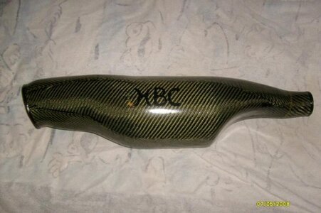

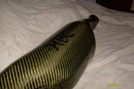

Here is my limited chamber.

Im just curious...
So how do you make the mold? Is it a 2 part mold then you have to connect the 2 halves at a seam? Or is it a foam disposable type mold that you lay up all at once and burn/clean it out of the pipe?
Very interesting and nice looking chamber 24/7!
It was nice to hear what the weight savings is and also I wonder if its just as good in regards to the reflection of the sounds waves as the alum chamber...
