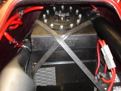

Filled it up with gas. Gas immediately started leaking around the bottom fittings....fast. Had to yank it out and drain it and use some liquid gasket 1192 on all the tank fittings. Don't use a JEGS fuel cell without putting sealant on the fittings where they go through the tank.

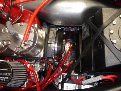

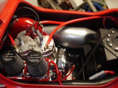

Reinstalled and Pabloescobar(Gregg) and I carried it to the water. Thanks Gregg! We discovered that my primer stopped working so we used a syringe to prime it and wham. It's loud! REALLY LOUD! Even with some water going in the fitting on the Highroller waterbox, it's loud. It has a rediculously deep tone like nothing I've heard before. This is with a rear only exhaust.
1st ride it seems to idle really high and the motor doesn't seem right. Then it just dies about 100 yards from my dock. Get it back to find the carbs are completely loose from the manifold. Spend an hour in the hot sun looking for nuts and reinstalling them with red locktight.

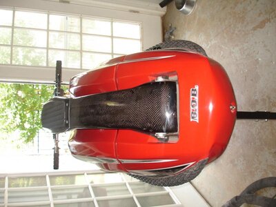

The ski definitely rides nose high compared to a superjet. The ride is completely different. I wish I had the recessed front foothold because I felt I needed to be further up in the tray. At speed it was no issue but definitely noticable starting out. I have the rideplate extended a little bit and a really short pole setup. I'm sure the pump sucking air wasn't helping this either and it may be the whole reason I had a hard time on the ski. I'm looking forward to seeing how it rides with the pump getting more traction. The wide tray had me overcompensating on the turns and I looked like I was a novice rider on it. The stunt was the same way and I expect to get used to that part pretty quickly. I did a half ass attempt at a flatwater backy and it shocked me at how easy it was to get it up and over. I threw it away and did a ghost rider because I wasn't wearing a helmet but I can't wait to try it with a helmet on. I expect it to flip easily.
