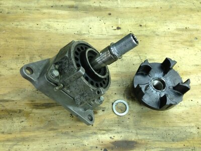

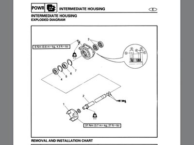

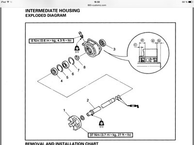

May i add to the post my recent discovery about midshaft housings.
I found that most yamaha couches uses the "same" midshaft housing as SJ, just sitting on a larger bracket housing. See picture
You can unbolt this, press your SJ or custom midshaft in and mount it, ride and be happy. But what i found out, is while it appears to be identical, the internals has changed a bit, only running single double lipped seal in the rear (sj runs 2 seal, 1 single lip and 1 double lip in rear)
This could cause some confusing (it did for me) :)
