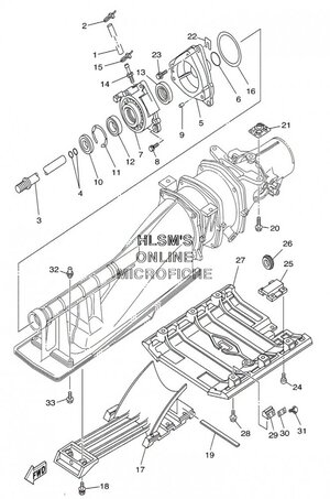

The XL midshaft housing is part 7 in this diagram. The part 5 does not exist in Superjets and Blasters. It seals the midshaft housing to the large pump tunnel directly, so eliminates water from the rear of the housing and Yamaha only used a single rear seal (part 13).
In a SuperJet or Blaster, however, the center of back of the midshaft housing is directly under water during use. Because of this water exposure, there are 2 rear seals in the back, both a single lipped one like in the XL, but also a sturdier double lipped seal designed for direct water exposure.

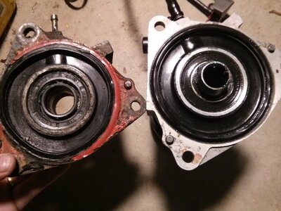

So, if I'm hearing you correctly, the seal setup on the housing on the right is not the correct one? The one on the left is my old one and the one on the right is the replacement and to my eyes they look identical. Even the inner bearings appeared identical prior to putting in the shaft.
The old one on the left has the wrong seal in the rear. The one on the right has the correct seal in the rear, but you can't see if the inner seal is there with the shaft in place.
