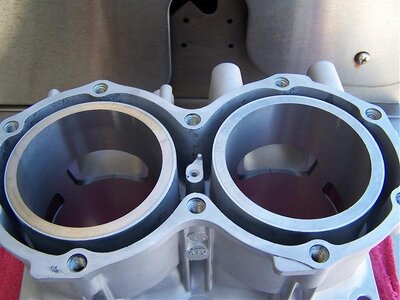

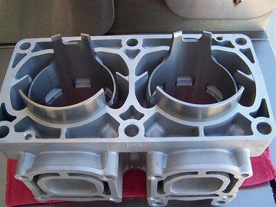

Well the cylinders are bored and man thats thin but oh well, installing the sleeves next.

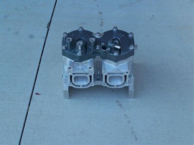

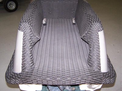

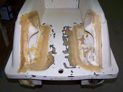

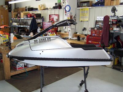

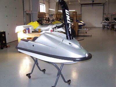

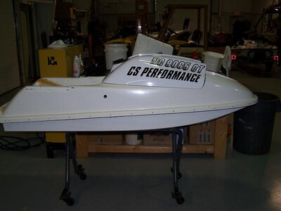

Well sence I didn't do a build thread the first time I did the ski here are some pics to tide you over.:drillsergeant:

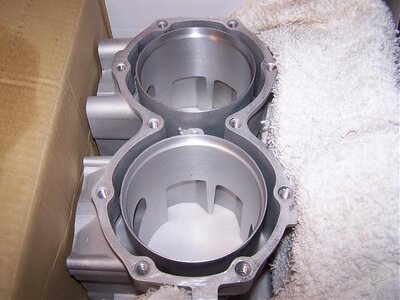

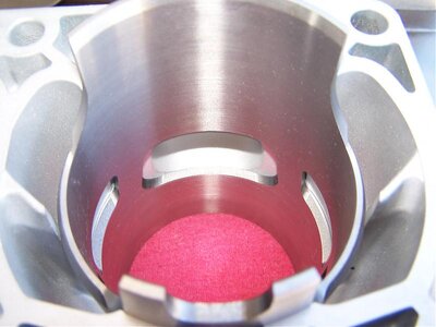

The cylinders are ready for decking, that was so easy droping the sleeves, also have to rough bore the cylinder before it goes out.

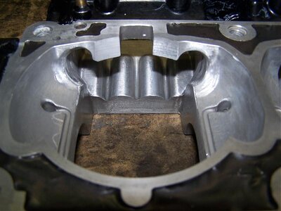

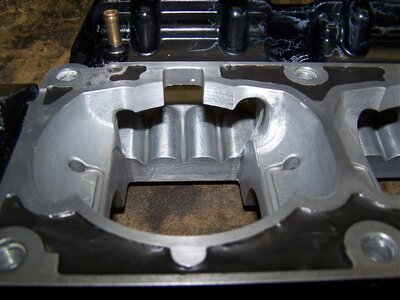

Started the grinding yesterday, and getting close on one side.

are you gonna epoxy the humps in the intakes?Looking great
Yea, I wasn't shure to do it after I started grinding or before, so I started grinding and thats how far I got. I will get it close and prob put the epoxy in the runner and smooth it all out from there.:icon16:

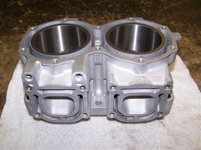

I never heard what those were for, I'm just going by the cases I've seen done by Tim Judge, I think they call it updraft porting. Also gonna use a angled reed spacer. Here are the cylinders decked, ready for rough bore.

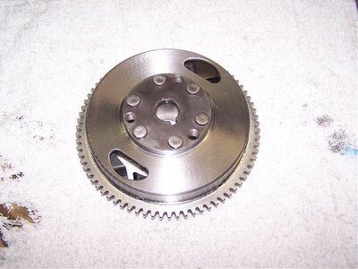

Oh yea, the flywheel is done, we took off .412 lbs, not to bad, looks killer, pic comming.

The finished flywheel, just need some clear paint.
