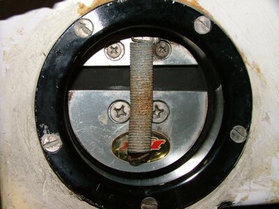

I have been sporting a spring on my scupper for about a year. It's been flipped over for as much as 30 sec. without any problems. It's not perfect it just slows down the trouble. That being said when I do it all over again some day I will pass on the scupper it's just not worth it for me. Not having a lanyard when your ski flips over really sucks some water in too. I think everyone I ride with sunk their ski for one reason or another, we just tow them in, drain them and get back to it.

I have been sporting a spring on my scupper for about a year, Its bin flipped over for as much as 30 sec. with out any problems.
I've looked at the picture for more than 30 seconds. Still can't figure out how it works (must be my laptop). Any details? The spring looks somewhat rusted, LOL...
Anyway, this is my take on the subject, run the scupper and plug it with a Champaign cork when you hit surf. Don't forget to turn your bilge pumps on.

The spring is being held by the top right screw that holds the flap. The spring was bent with a loop at the end. I need to find a stainless spring, crc corrosion inhabiter helped for a while.
