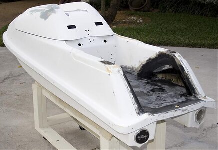

Today I completed all the fiberglass and epoxy work. Actually, I plan to make a mold for a front left foot hold that mounts to the firewall. I am lost without being able to plant my left foot under a lip (like you can with a SN/SJ). I will try to also make it a storage compartment for rope and other critical things.
Layed down 12oz biax on foot tray to tie in footholds - notice how the biax was cut to fit inside footholds (1-piece). Joined sides with more 4oz cloth. All I need to do is feather in the fiberglass (it will harden by tomorrow).
hate the holds, but love the instal and reinforcement instal too, nice work bro. :biggthumpup:

Hopefully I will have a project RN hull coming to me soon. I want to do a reinforcement buildup like you are doing. Your glass work looks sweet!! and if you only gained 6 pounds, I think it is worth the time and money.
i was thinking i have a extinguisher compartment (the kind with the handle) you can have it to hold your rope and stuff. shove it under the tiedown for the fuel tank maybe
Thanks for the offer bro. However, I've got the yellow container and a black fire extinguisher. Come to think of it...I have too much stuff, need to get rid of to make room for more stuff :woot:
Keep in mind not to over saturate with epoxy (ie. heavy and more brittle). Its a common mistake I see to often...gotta let the fiberglass do the work.
As for the "worth the time" comment...doing fiberglass reinforcement is a must for surf riding. I'm only doing this because I must and not because I like doing this. I rather ride then work on it.

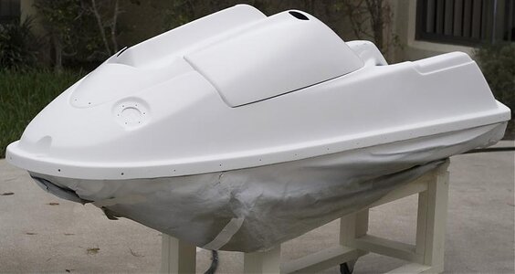

Was able to work on it for 5hrs today :arms:
Another full day in prep and it should be ready for gelcoat.
BTW: Thanks everyone for the compliments...when I don't feel like I'm making progress, it helps.

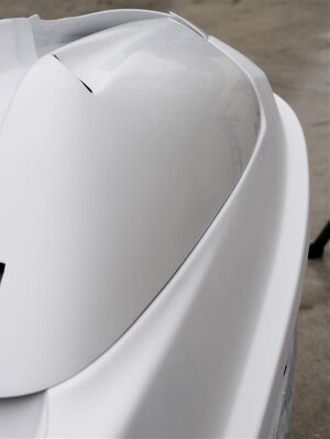

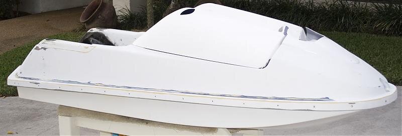

UPDATE: 12/26/06
Well, I haven't been able to work on my SJ because for the past several weeks I was working on a different "job" :sneaky:
This past friday I bought a gelcoat cup gun, 1 gallon of gelcoat, styrene, ect... Well, I finally finished with all the gelcoat and I'm ready to wet-sand and polish. The picture of the hood shows how it compares to the rough sanded body. The hood was wet-sanded with 1500 grit (but not polished).
I hope to completely finish the hull work this week so I can begin installing and setting everything else up.
When I took that "job" I knew I was risking not being able to finish my SJ for Daytona...but it was a rare oppertunity so... :woot:
As it stands, finishing it for Daytona is 50/50.
(more pictures when I finished wet-sanding/polishing)

lookin sharp man, i should had you gelcoat my boat. how much you charge in?
This is the first time I've re-gelcoated a ski (completely). The hardest part was removing 100% of the old 2 layers of thick paint in order to apply this. You can't imagine how time consuming it is getting old (thick) paint out of all the tight spots like hood rail. I did it right by not using any body filler anywhere. All glass and gelcoat everywhere.
Also, spraying gelcoat with a cup-gun leaves massive orange peel that must be sanded with a R/A 220 then wet-sanded with 320, 600, 1000, 1500.
Now I know why everyone opts to paint. At least now when I'm bashing rails with friends at WOT I will easily be able to gel patch.
Uhmm...I'll trade you the W hull for a re-gelcoat job :purr:

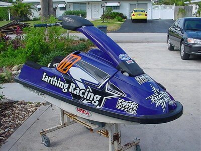

tricky1,
I'm pretty sure that is the actual hood that I got (nose cover too). It had the same blue paint and Paul (his driveway pic above) had it for a while. It had been modded on the inside for a dry pipe and someone used like 5lbs of resin to patch the inside...I removed all the mess and its now repaired correctly (back to original). Weighs only 13lbs again.
