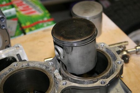

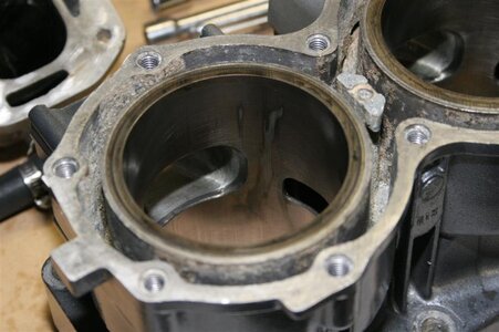

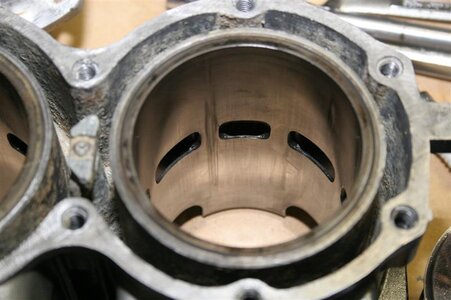

60 minutes into my easy "break-in" ritual I was heading back to shore doing 15 or 20mph (3K to 4K rpm - constant speed for 200ft) then it gently (if there is such a thing) siezed. I say gently because after it seized it started up...but I only idled to shore. Tore top end down and my rear piston is toast.
The story is very odd however and many things just don't add up. I check compression and its 195psi on the front (good cyl) and 190 on the rear (seized cyl). The odd thing is I am using 35cc domes and should have a mathematical compression of 185psi...not 195psi.
It gets even more odd. I made the mistake of not double checking the new bore clearance (piston to cylinder wall)...in the rush I "assumed" the machine shop did their job. Turns out there is .065" piston clearance. While this is a little high, certainly not the cause of the siezure. If nothing else, it would/should have helped with the greater clearance...not caused it.
Carbs were jetted right (135/72.5) and screws were fat. Base gasket was mint. Cases sealed well.
I'm scared to re-bore it and throw new pistons in it because I didn't find anything really wrong.
The only 2 things really odd is the larger clearance cylinder and I'm using a Blowsion billet head (with 35cc domes - on non big-bore 61x).
I am so sick about this because it just doesn't make sense. If I found the problem during disassembly, I would rush to bore, new pistons and get this done....but without a clear reason...:banghead:
Ran fantastic for the first 59 minutes.

Sorry to hear about the problems Sanford. It looks like it may have been a 4 corner seizure, can't really tell from the pics. You probably can lighyly sand & reuse the pistons;muriatic acid may have cleaned the aluminum off the cylinder walls.
