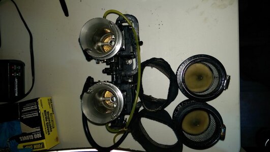

I also just found out I have a 64x intake manifold that was ported, with a reed spacer, and some sort of carbon fiber reeds (see pic) fed by dual mikunis 44's.
Question: if I'm looking for an awesome freestyle setup are these 44's gonna hurt my low end torque?
Also anything else look out of place in any of the pics?

looks like it will be a nice setup once you clean it all up and make everything right...Id run those 44's as is since you have them, they will work well no need to change them...also looks like some vforce reeds.
