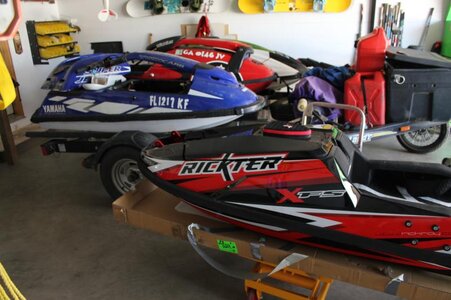

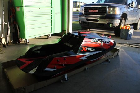

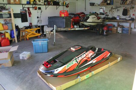

Finally after a little over 8 months and 2 different hull purchases to try and make it faster my hull has arrived. badvinny i purchased my motor and first hull through and he was amazing to deal with but i ended up ordering another one because of several pushback dates from rickter. i posted a link on this website if anybody had one ready to ship and got a reply from a member who lived down under. he told me his was done sitting at the rickter wherehouse in thailand but it was a xfr i said sure whatever it took to get to ride it in my short short summer. it was done july7 but apperently that doesnt mean crating and paperwork i recieved my hull august 15 after paying 2000 to have airfreighted to a city 2hrs from me.
I am sacrificing my 97 superjet for most parts but this is what i have going into it now

BODY/ HULL:
RICKTER XFR BLACK GLASS HULL (125LBS)
RRP BILLET POLE (EVERYTHING ON 14LBS)

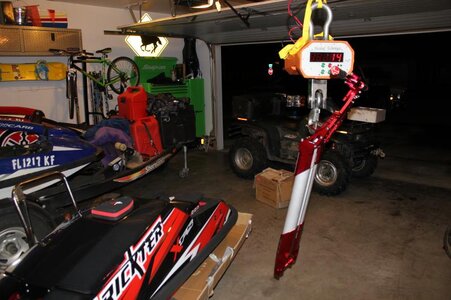

i WILL BE POSTING WEIGHTS OF EVERYTHING FOR YOU GUYS BUT FROM WHAT I HAVE BEEN ABLE TO MEASURE SO FAR WITH PICTURES FOR EVIDENCE IS
HULL WITH HOOD - 125LBS (THE PICTURE WILL SHOW 128 BUT THERE IS 3 LBS OF STRAPS)
HOOD - 11LBS
RRP POLE,BARS,STEERING SYSTEM 14LBS
SHORT BLOCK - TO COME
(IM ON LOCATION RIGHT NOW SO PICTURES ARE TAKING FOREVER TO UPLOAD SO BARE WITH ME)

Sure glad you finally got it Ryan, looks great too. Kind of a battle tryin to buy it but nothing good comes easy right, lol!
tx, Rickter hulls retail for $6500 if you can find one, hull and hood w/pole bracket and adjustable motor mount plates (pole is extra)

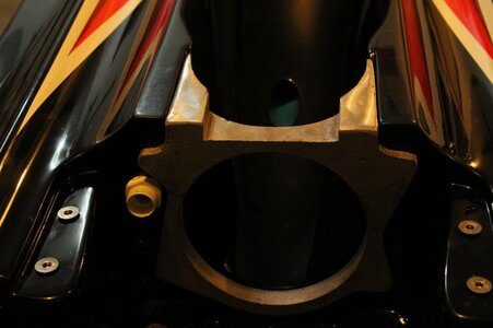

so tonight i installed the alluminum pump shoe..... it didn t fit very well as you can see from the pics but a few hours of grinding and were back on track
I'm going to changethe jets, springs , needles on the carbs and put the bed plates on the motor and I'm going to look again at the pump shoe. Its still not perfect...close but not there. Does anyone know if its absolutly critical that it is perfectly lined up? Its real close I would say 1/8" max gap on top half.
