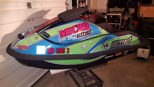

-781BB with dual 38s, lightened factory flywheel, ADA head, and Jet Maniac fly wheel cover (BIG thanks to Chris and Blue @ JM)
-Jet Maniac Ebox refresh with MSD and kawi coils...red wires and braided nylon (Thanks Chris!)
-Factory B pipe ported by Wamiltons
-Re-turf by Eric Malone
-148 Solas mag pump with skat trak cut back prop
-Thrust trim
-X Metal cut and welded hand-pole (Thanks Eric!)
-Water line quick disconnects
-Push bulb primer
-Limited slip modded tank
-X Metal water-box
-Blowsion finger throttle and quick turn plate
-Modded straight bars (Thanks again Eric!)
-Triple water bypass
-Dual bilges with Hot Products bilge switch
-Alien Battery with Cold Fusion battery box
-Jet Works water control Valve
-Cold fusion fuel filter

EME Micro is set up for a kawi based power plant. Adapter plates/mid shaft extender have to be used to run Yami..hence right hand pull...
Nice build very close to what I will be building hopefully in the next few months (got the hull, pump,engine, and limited slip tank already). I've got a few questions for you, where did you get the adapter plates and how bad was the process of setting them up for the motor? What length of handlepole did you go with, also do your pole mount bolts bolt through the handlepole mount or bolt directly into the handlepole mount?
