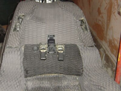

my second sn build
lots of work there... i was going to do my gunwales on my RN but im afraid of making it heavier... i heard of people wanting to try the turf idea but every one is afraid of it peeling up. I hope it does work out well for you. looks sweet. youll be able to grip the whole ski when riding! ill have to check this beast out in Daytona.
lol yup, hopefully itll work out good for me
maby ill even let u try it out ha ha
With that much turf i have a few ideas that have never happend before in the surf...
double check your corners for sure though.. once you start thrashing that chit it will come up for sure if you dont...
haha yeah maybe we will trade skis for a a lil. i like trying new skis

I think I realize why you turfed everything now.... After foaming my nose similar to how you did it, I'm going to have my work cut out trying to smooth it over. The foam was perfect when I laid the fiberglass. Now it looks like crater city!

cabosil is your friend on the nose.... took us three layers on my buddys square.... it still needs some more work... sand and fill, sand and fill.

Dude, the turfed ski is SICK!!!!
Nice job, only thing I would recommend is to cut your nose turf off and wrap the nose section (where the cover used to go) and turf it in one solid piece.
Have you tried to pull off a fountain yet? With all that turf I bet you could hold on to the ski down to like 6 feet underwater!
ha ha no i never even rode it yet :( im gonna ride it in daytona... itll be my first time and ill see how it holds up cuz i dont have enough turf to redo the whole nose

Superglue ALL the edges or I can almost guarantee that they will lift up and tear off.
