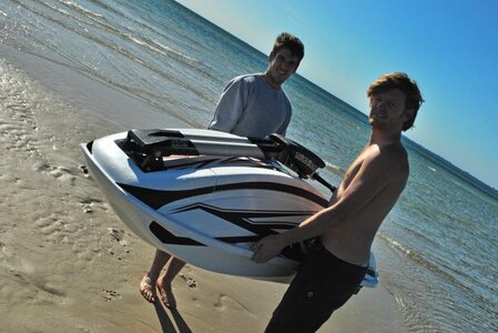

I seen lots of pics on face book... Nice looking hull
Need some video with different power plants... Pump tunnel looks a little small for big cc flatwater skis, IMO

These new hull pics are different from the first one posted. The side material is missing in the new pics.
The body looked really unique that way, but it really just was unnecessary material there taking up weight and most importantly area for body movement while riding..
Still is a gorgeous looking hull.

Thanks for the comment and you nailed the reason the design was marginally altered.
We trailed a selection of different intake tunnels over the three prototypes, one of which was a great deal larger than what we ended up with on the final production model, we found this tunnel to work well.. keep in mind the centre beam on this ski is larger than your SJ, kawi, BOB, matrix etc, so it may be an illusion that its appears smaller, its actually holds a large volume...
Need some video with different power plants...O
absolutely! this is what we are currently working towards.
