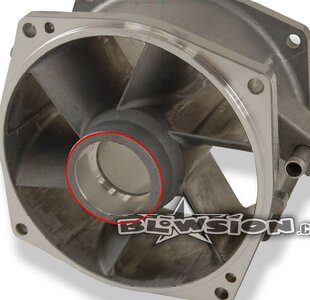

I just had the same issues with a cut back prop, the hub was bottoming out on the hub of the stator section. As long as your blades aren't hitting the stator (doubtful) I would check to see if this is where it is hitting. I took a marker and marked the outer edge of the pump hub and spun the prop a few times while it was just barely touching it. I took a file and chamfered the corner of the hub a bit and it worked perfectly.
The area in red was where I was hitting, knocked that down quick and it freed right up.
